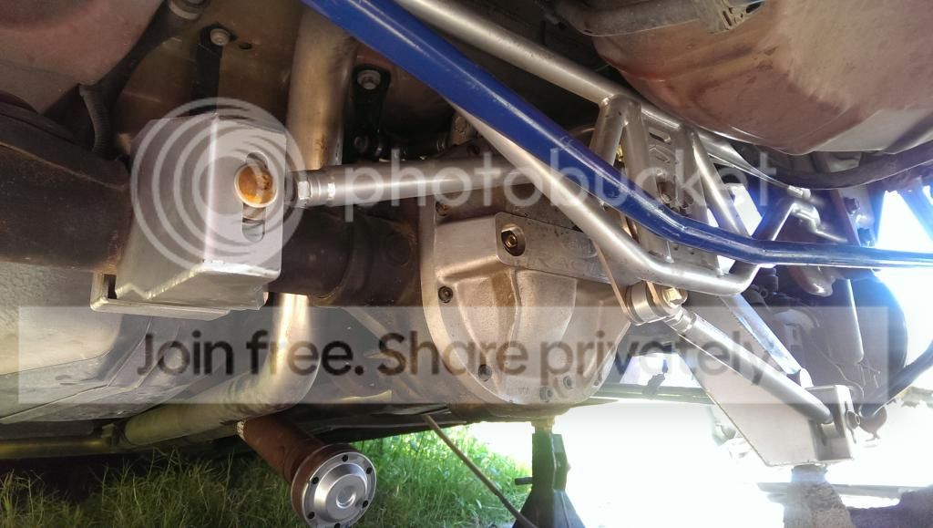

Swapped out my diff with one that had a steeda watts and 3.90 gears. Feels awesome with the gears.

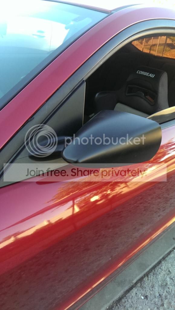

Oh and some agent 47 mirrors

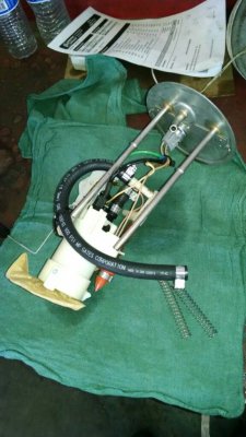

So my car died today. Tried to start it and it wouldn't restart. Fuel pump primes, no leaks right? Right before it died my Afr dumped lean and then dies. So I pull my fuel pump and this is what I find. Fuel hat in pieces basically. The high pressure line came off the top of the hat and the springs went to the bottom of the fuel tank. uploadfromtaptalk1409791273578.jpg

Get a magnet on a stick. I picked up a flexible grapple tool and magnet on an extendible stick both for $3 last month. Hopefully you can fish the springs out of the tank. I already used mine fishing my drain plug out of the oil drain pan last week.
