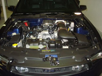

Got it together finally. Not sure of the power numbers, but it ran a 12.3 @117 at the track this Saturday on stock P-zero's. Only other mod is a Roush axleback.
