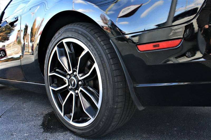

As the title says. They are 19x8.5. anyone have any experience with fitment with these wheels? I refuse to use any other wheel as I love these wheels!

According to the brochure I have, these will not fit with Brembo brakes.
With that, you can always try to use a spacer to see if it helps with clearance to the caliper. If it's a spoke interference issue, the spacer may help. If it's a barrel interference issue, a spacer most likely won't help.
Now, with a 8.5 inch wheel, your choices in tire fitment will be limited and this presents a compromise since you'll want more rubber on the road with larger brake setups to maximize the stopping potential.

Guess I'm sticking with stock brakes [emoji51]

It was just a thought. I think I figured it out. 1/2 wheel spacers will make em clear

For that much, you'll most likely need to get longer wheel studs. 1/2-20 studs should be getting at least 10 full turns of the lug nuts (one stud diameter's worth).

Looks like u have 245-45-19"s...goodyears.
Even Hawk HPS-5.0 is an ample pad for street use...even from 100-0 (front + rears)
Swap to braided SS brake lines.... + use better grade of brake fluid, like Willwood 570 or Motul or ATE-200 etc.
When was the last time u looked at the brakes ?
Do the ABS brakes activate, when u stand on the brakes at 100 mph ?
Yea it's what came on the car. They are brand new
