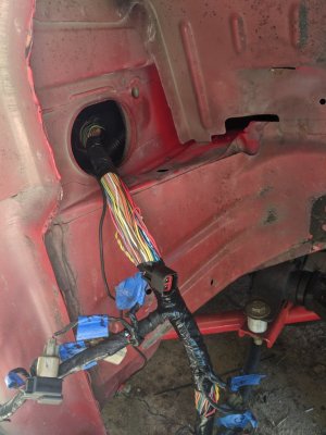

I have a 0 gauge wire from battery to block and either 4 or 2 gauge for the fuse box, sounds like you are placing everything in the same place that I will be. Will you be running all the wires back out through the passenger firewall opening?
I have the PCM in the fender and then the fuse block underneath the dash passenger side. I am running the wires out through the firewall on the passenger side.

So is this the point everyone used in the firewall for the wires and from there were the wires run into the engine bay through the opening along the firewall? I'm mounting both PCM and BEC under the dash.
