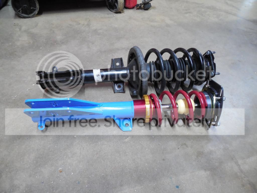

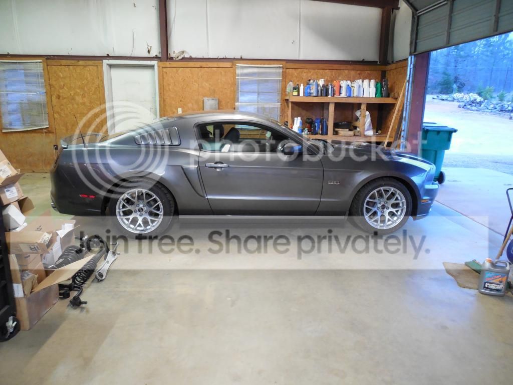

Just to add to ride height comparison pics in this thread, I was able to achieve a max ride height that is only 1" lower than stock with Ground Control coilovers.
The adjustment collar had to be adjusted all the way flush to the top of the strut body to achieve the height above, but I think it's a great compromise for folks looking for near near ride heights. (pic taken before final ride height adjustment made)

That strut looks to be the same length as the factory strut? Did you request that from GC, or is that their default offering?

If the body of the strut is the same length as stock, then I immediately know that the suspension is still limited in compression. That's a bad thing. Granted it's hard to tell in that picture which is why I asked. I did ask the wrong question since it looks like I meant overall length. I'm really interested in the length of the body.
Without any car weight on either of them, and with different rate springs on each, I don't think any useful conclusions can be made.
Norm
Sorry for the late reply, I work in a whole different time zone. (Afghanistan)
No, the Ground Control strut body is a shortened version to allow for additional compression stroke after lowering. I cannot get measurements of the strut body at the moment, but I can tell you the springs are 7" long 430lbs/inch rates. From memory I believe the body itself was 2" shorter than the OE Brembo package struts.
If you look at my previously posted picture of where the height adjustment collars were at from CG and installed it on the vehicle, it would look like the following picture. I had to bring the weight/height adjusters all the way flush to the top of the thread insert to achieve my desired ride height. (very first picture I posted above in other post or last picture in this post)
End result after raising collars to the top and evening out all sides of the car. I left a little rake in the ride height on purpose, but still need to corner balance it on the scales when I get home on leave next.
IMO, this is an excellent DD and occasional HPDE setup. It still retains tons of clearance for driving everyday on the street and enough spring rate and damping for track use with the help of a Strano front and rear bar.
