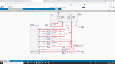

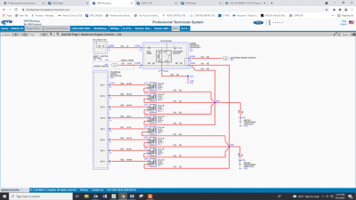

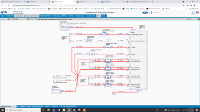

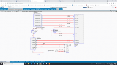

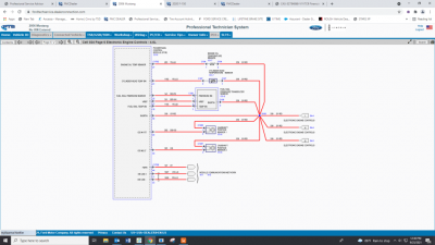

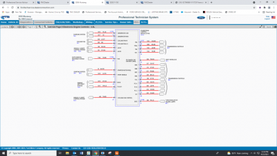

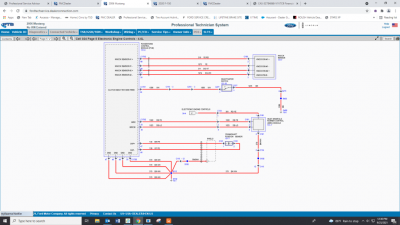

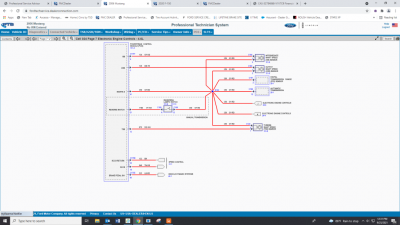

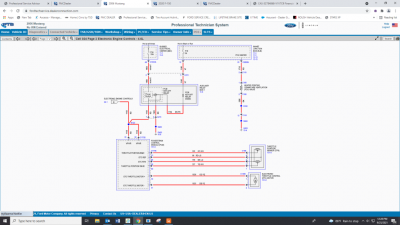

Prior to replacing PCM I'd look at wiring/connectors/active components (parts that move) - Look up what the manual has to say about it. Do end-to-end connectivity checks. Check/reset the connectors; check the pins on the TB back to the PCM. Check voltage levels at the connectors for the throttle body (back probe as needed). Check control/ground wires for the throttle body. Clean throttle body. Ensure gearing/movement is smooth. Try another throttle body.
https://iihs.net/fsm/?d=5
