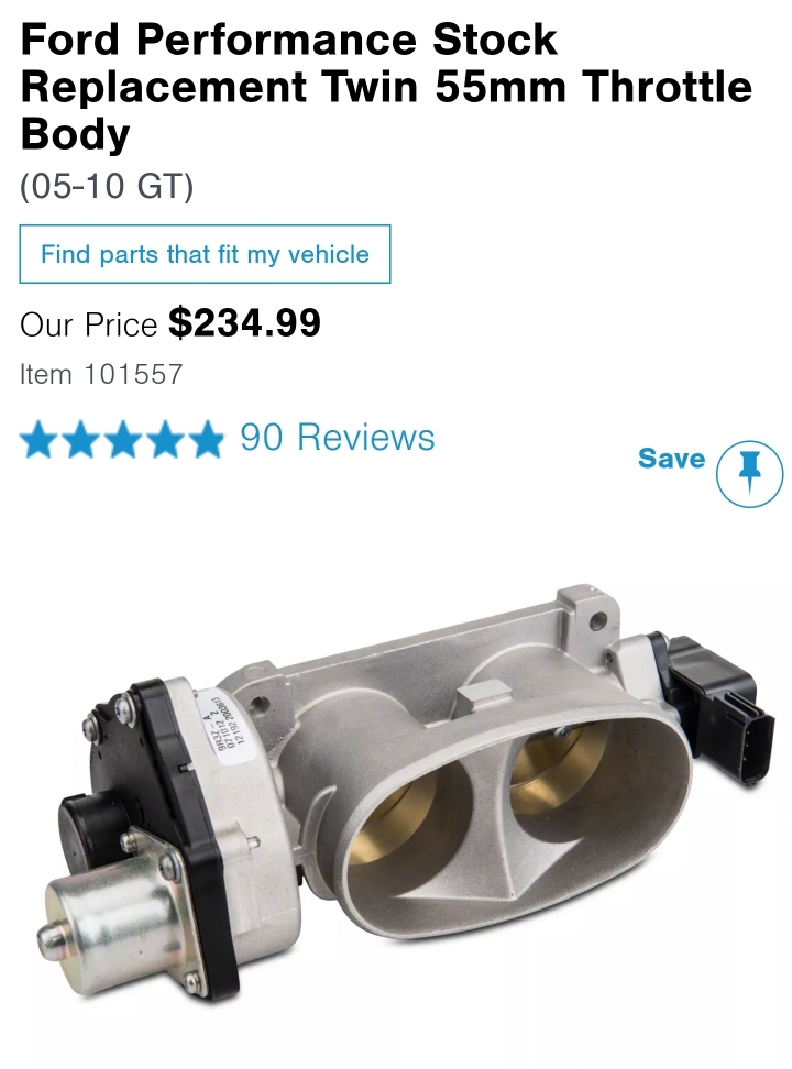

P2104 and P2112 are likely the TB motor.
There is a Dorman replacement motor (part # 911-102) but I would just buy a new Motorcraft TB assembly (send back the TPS you just ordered cuz' you'll get a new one with the new TB) . American Muscle has it for $234
