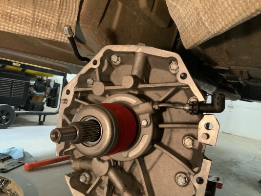

Just to be clear. It is important you measure the preload using the parts you intend to run. If you use the stock flywheel, have it resurfaced and then measure the preload. If you intend to run a new flywheel use it when measuring. The stack height will change with different components. This includes the clutch disc and pressure plate.

@ Midlife Crises. Yes, I understand what your are meaning. Every alternation of the set-up..Flywheel.. Clutch Kit.. a.s.o. will result in a different preload number. And this results in a different shim /spacer thickness.
My biggest concern is the "right " preload number.. i.e looks like 1 inch ( 25.4 mm ) is the number most of the guys are talking about ..
But when I think about the function of the TOB and the working area /space.. I see only 0.43 " (11 mm ) left for the space that is needed if the clutch wears out / the TOB bottoms out. Because the complete working stroke of the TOB is 1.432 " ( 36,43 mm ).

tomorrow I will ask the "lathe master " again, if he can reduce my 0.5200 spacer I bought from Summit. With the new flywheel , the new LUK clutch kit, I have a total preload of 0.4649 if I add the 0.5200 spacer - the preload will be 0.9849 .

0.9849” preload would work just fine.

@ Midlife Crises. So I will install all the parts now... hoping that everything works thereafter .
My concern is the little space -left for the clutch wear... 0.4 inches until the TOB reaches the end of the compressed travel /space... I don´t want to replace the clutch after 30-40 k mls... or so
If the measurements you have given are correct, you will compress the throwout bearing 0.9849” when you bolt the transmission to the engine as long as you use the 0.5200” spacer. This will allow more than enough room for full clutch movement and disc ware. The clutch is hydraulic so it will adjust itself as the disc wares and you will never know it’s happening. Also, by the time you use up four tenths of an inch of clutch material the rivets will be dragging on the flywheel and/or pressure plate and the throwout will still have room to work.
If you have your lathe buddy reduce the thickness of the 0.5200” spacer, wouldn’t you have “less” preload?

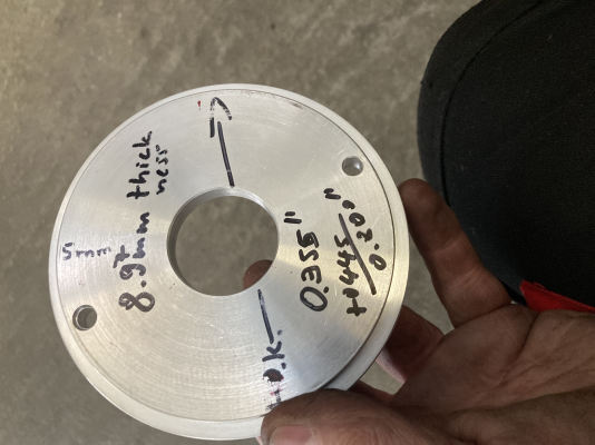

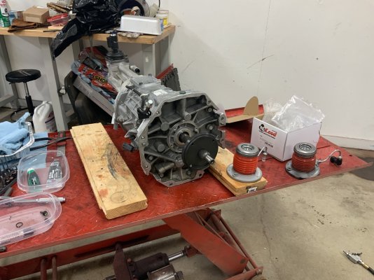

We made a new spacer today.. 0.350 " ...so total prelaod is 0.767 "with the old flywheel . And 0.817 with the new SACHS flywheel....
BUT. the next "nightmare " appeared right now... The new LUK clutch disc is rattles. The small inner springs of the torrison set-up rattle awful inside the bigger / taler springs.. Looks like I need another clutch disc...

If it’s any help at all. This is the spacer I used when I installed a T56 mag. XL and a McMeod twin disc. Notice the spacer is flanged to center itself on the transmission and the throwout unit centers itself as well. When it’s all bolted up (using longer bolts) you can’t even tell it’s there.

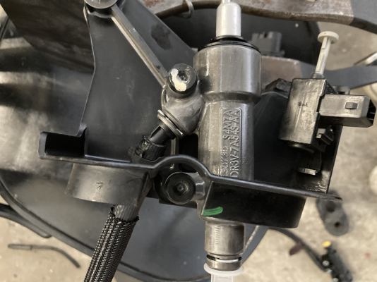

..while waiting for the new clutch to arrive.... I changed the master cylinder . Went with the GT 500 master, hoping that it was a good idea to go with the GT 500 instead of the Sachs master cylinder
Removal of the pedal assy was o.k. ( more or less ). BUT when it came to install the assy back -with the new master cylinder....it was a pain in the a... nightmare... wanted to burn the car...

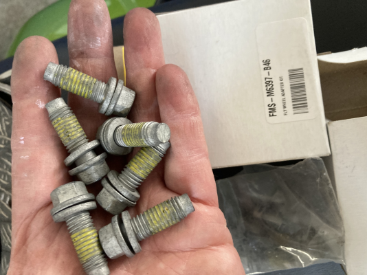

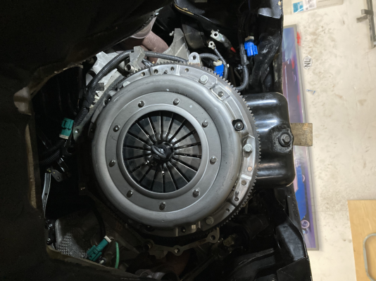

The transmission is back in the car... I used new bolts on the PP , from Ford Racing . btw.. the FR bolts have a 12mm hex head..the OEM has a 13mm hex head . the torque for FR bolts is 63 NM + 60 deg... the OEM calls for less NM +6ß deg....
The preload on the TOB is 0.740 " with the new Sachs flywheel and the Exedy FMK 1011 Clutch Kit.
I hope that the preload is good enough for the use of the GT 500 master that I installed also...
What do you guys think... 0.740 " with the GT 500 ?? or is the preload to small for the bigger Master Cylinder ?
