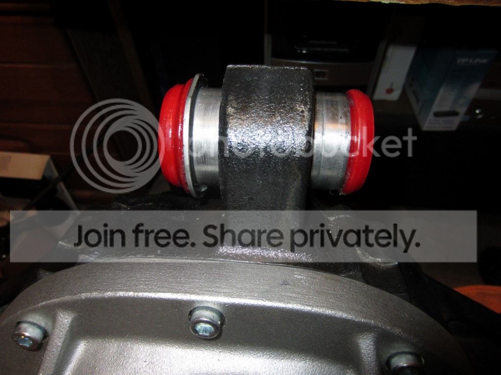

I got one from BMR. Nice little 5-piece design that looks like it can articulate pretty good without binding. This one uses the OEM casing for the bushing. Just used a hole saw to cut out the old bushing and then a wire wheel to clean it up

I went with the BMR bushing as well. Rubber and steel sleeve were removed from the OEM bushing with a drill and whole saws then cleaned up with a wire wheel.

I used a bolt and washer method so I could just hit it with the impact. Took long literally a second to press it in.
