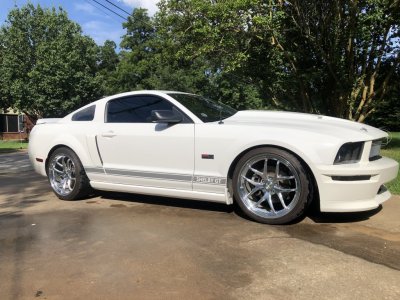

Mark Zilio
Jun 26, 2021
13
Beautiful Car Nelson
Nice set up with the tires/wheels. Do you happen to know your wheel off-sets?
Thank you

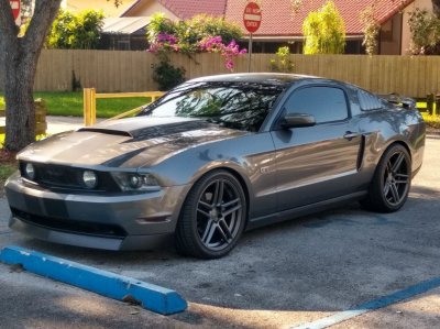

ShelbySteve
Aug 27, 2020
168
66
20x9.5 front and 20x11 rear with 285/35 rear and lowered 1.5” on frpp with no issues
