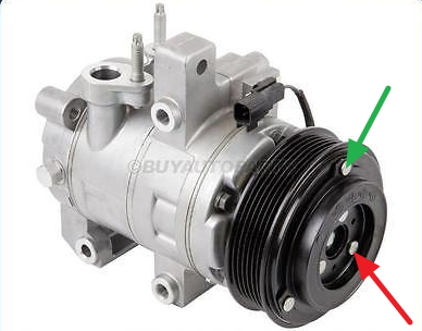

I looked a little bit closer at it, and found that when I turn AC on, the outer portion of the compressor pulley begins to spin (marked in green), but it's the center section which rotated slowly then stopped (marked in red).
Any ideas?

Sounds like the Clutch has gone bad. How many miles on the car? I know the parts are available but I have never been a fan of replacing just the clutch assembly. Always seems to be a compressor concern not too far after. Get Ford Parts if you choose to just replace. the Clutch Assembly. Will be 3 pieces needed.

I had that happen to me a couple of months ago (of course right after installing the Borlas). I also noticed a small ring of melted rubber where the outer part of the compressor clutch meets the rubber damper joining it to the inner part of the clutch. I had the dealer fix it. In my case the A/C compressor itself was okay. There is a clutch service kit (pulley/coil/clutch), but pulling the pulley from the compressor has to be done off the car (evac and recharge).
Shimming won't help if the clutch has already failed. It is something that should be checked when installing the new compressor clutch.

Okay, finally got back in town and yanked the inner clutch portion. It is for sure toast. Rubber separating.
I'm wondering whether replacing that alone would be a bad idea. I have the whole clutch pulley assembly, but obviously replacing everything will take longer.
I popped the new clutch disk in for a test. It seems to work well. Everything is locked together with the AC running, and it blows cold. Sweet!
When I turn off the AC, it mostly disengages, but not completely. The clutch very slowly rotates in little pulses. Only a few RPM I'd say.
Is that a sign of a worn out pulley, or it needing shims?

Replace the whole clutch at the least.
There are 3 pieces to the clutch assembly that need to be replaced.
The service manual says that each individual component can be replaced as needed. So long as there is not excessive grooving/wear in the other components.
It is pretty clear on my system, that eventually the outer portion of the clutch shifted and closed the required air gap. With it now rubbing against the pulley and generating additional heat, the failure is no surprise.
Can anyone explain to me why our pulley's band of friction material is flush with the surrounding metal faces, and the mating face of the clutch, has no raised section?
It seems that by just cleaning it up, and shimming the new clutch for air gap has everything functioning well again.
