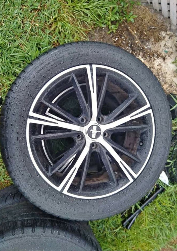

Seller says they're off an 07 gt/cs but I can't find them online anywhere can anyone tell me if they're oem wheels?
full
Those are most definitely not stock '07 GT/CS wheels. The stock wheels would be Bullitt-style
