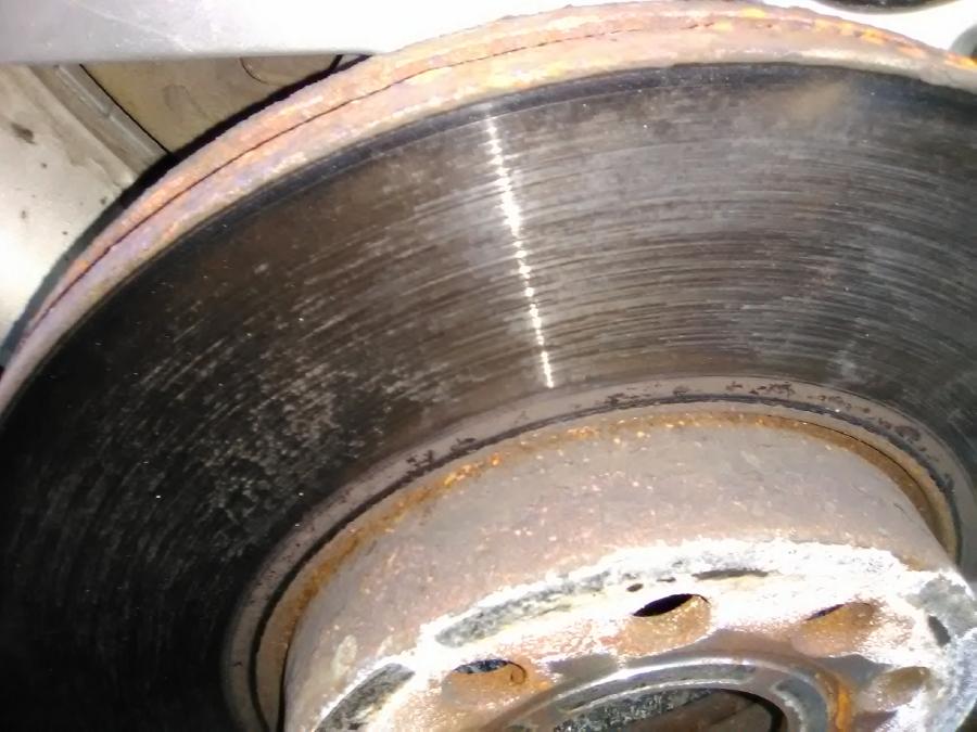

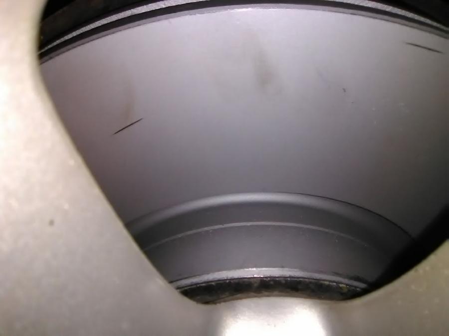

Example:
288MM ROTOR:
312MM ROTOR:
Look at that gap from the HAT to the PAD surface, compared tot he 288MM rotor.

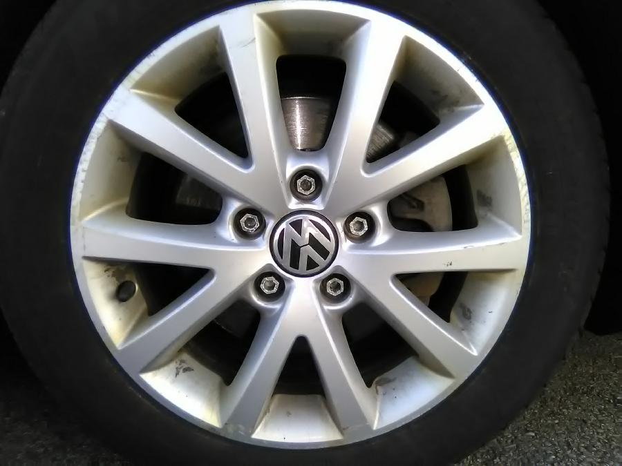

That is kind of how they cheat with bigger factory brakes. Look at the difference
too, from the wheel:
288MM -vs 312MM:
Look how much farther out the caliper was pushed out, with just the brackets.
You can also see the space there between that spoke, from the hat to the rotor
that you do not see in the 28MM rotor.

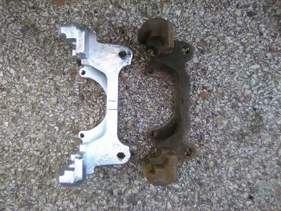

BRACKETS:
Left bracket is for 312MM rotors, the right one was the 288MM. That's all they do
in some cases to make bigger brakes. IT dissipated heat faster, but the pad surface
remains the same.
