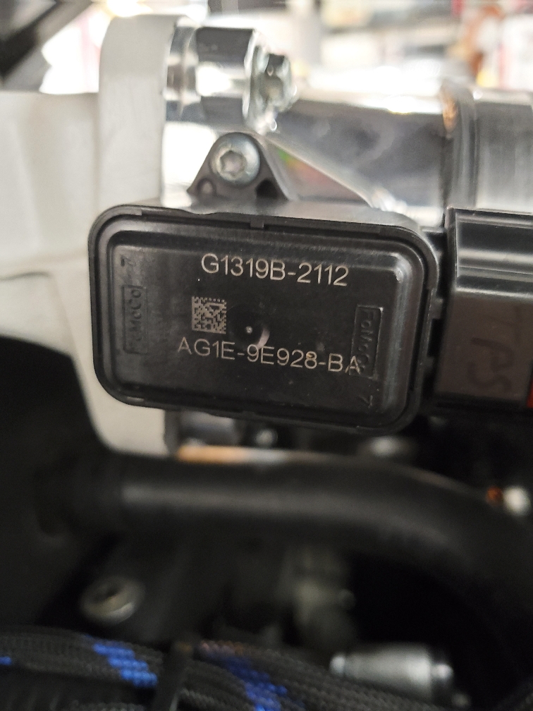

One other thought is to clean up the throttle body and make sure you have the latest throttle body position sensor... There are three versions. The latest one is a rectangular box with the connector on one end (pic below) the older versions are egg / oval shaped.
