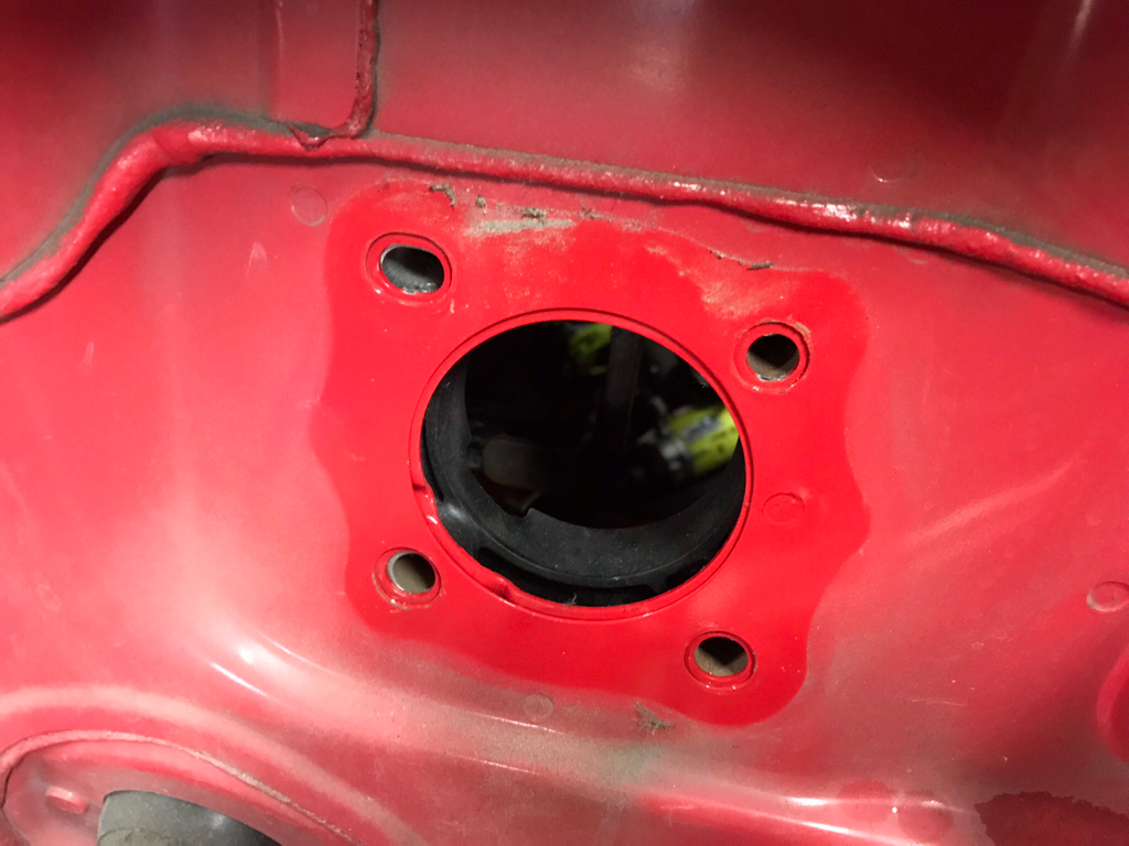

Thanks to some helpful guys on the Facebook S197 Forum group, I got the VCT solenoid removal covers.
Here are the part numbers:
5C3Z-6N881-AA
5C3Z-6N881-BA

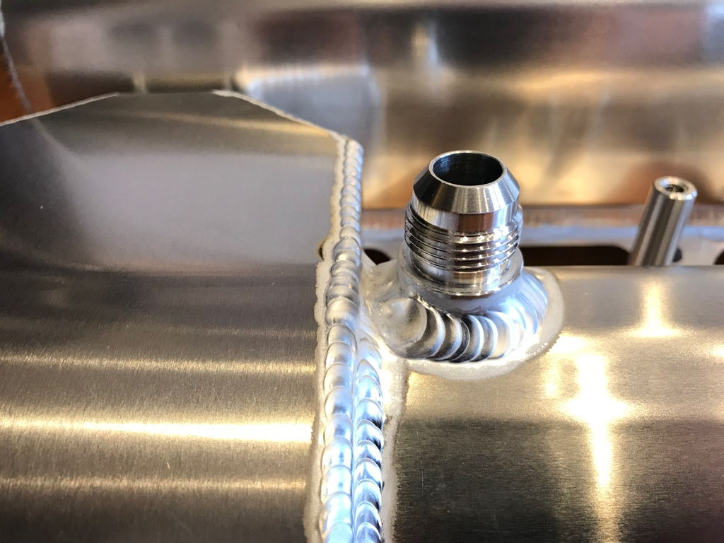

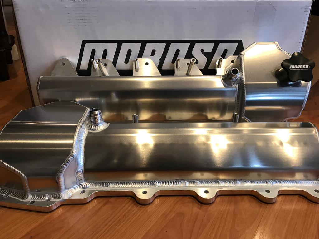

A huge thank you to Moroso Performance Products, Inc. for these amazing custom valve covers! Absolutely phenomenal product. No VCT holes, and 10AN ORB PCV spouts!
Now to powder coat these with Prismatic Powders "Very Red".
In case you didn't know, while #Moroso offers the off-the-shelf version, they have a custom shop and will tailor-make your order.

raredesign
Apr 13, 2015
382
37
Rochester, NY
Those are bad ass!! I have really thought a lot about getting them only because I am not about having what everyone else has. I am sure they will look sweet powder coated. Was going to have a cousin weld a set up in stainless. Alot of work when he and I started planning it out.
Thank you. I had originally looked into modifying the stock covers, but multiple welders told me they were unsure how it would react since it is pot metal, and after considering welding on a bung with possible trouble, closing off the VCT solenoid hole, and powder coating it, I would still have a glorified stock cover.
These Moroso covers are perfect and I highly recommend them even if it requires saving up a bit.

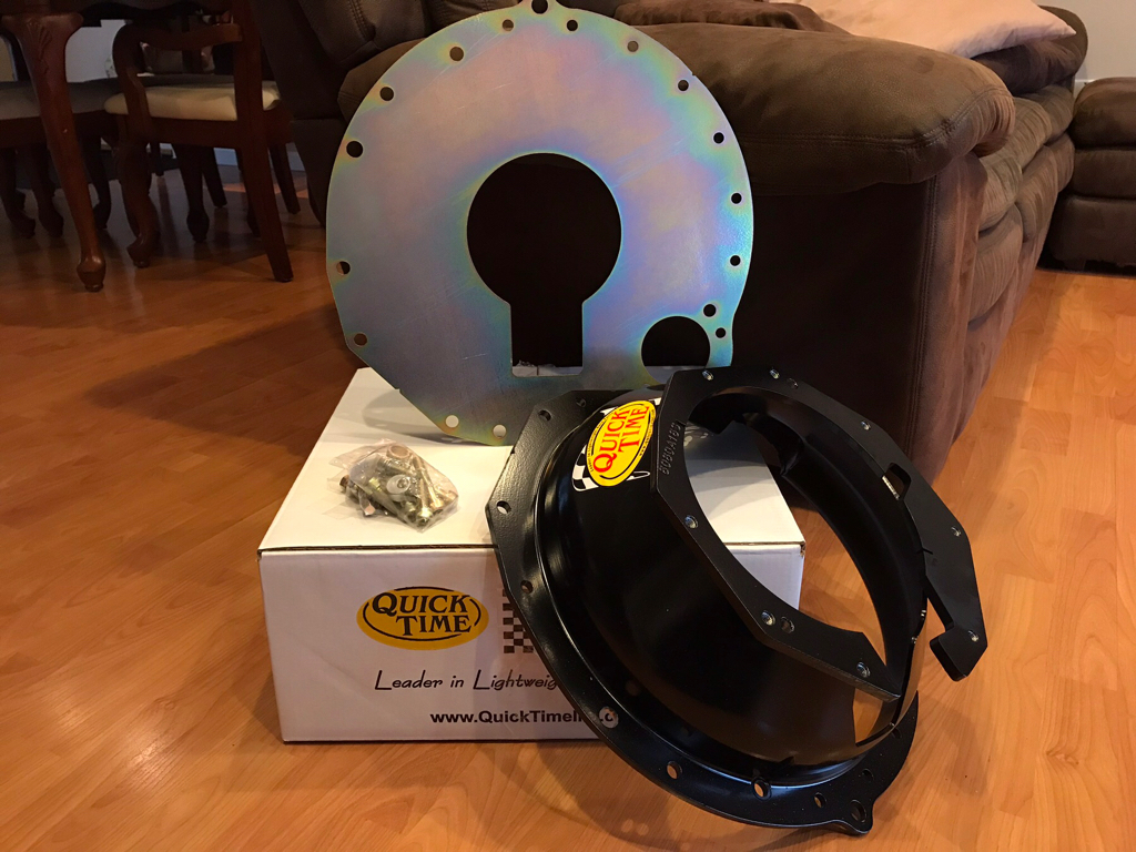

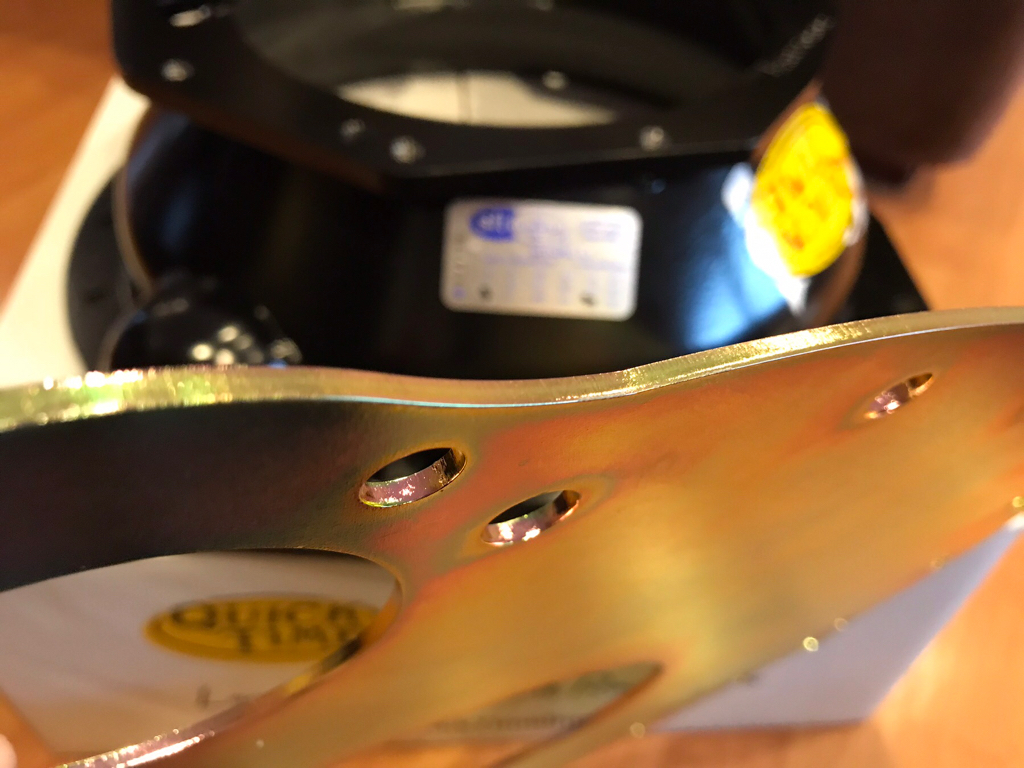

A huge thank you to Holley Performance Products for setting me up with this amazing RM-8080 steel bell housing! Absolutely more peace of mind!
Sent from my iPad using Tapatalk Pro

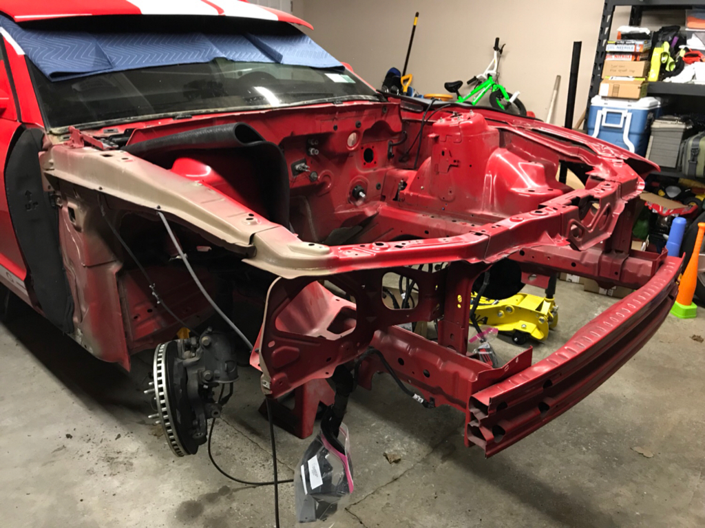

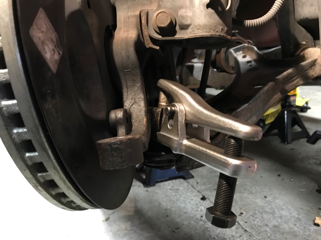

In case it is not entirely obvious, here are some things I learned that will hopefully help others out.
The control arm ball joint spindle is held by a pinch bolt design. I used a brass hammer to knock it out as it was locked in pretty good. For extra protection, put the nut on the end of the bolt so it doesn’t mushroom.
The easiest way I found to remove them was with a simple ball joint separator I rented from Autozone.
It too was frozen pretty good, even with only 48k miles on the car. I would assume it is more about age and less about use.

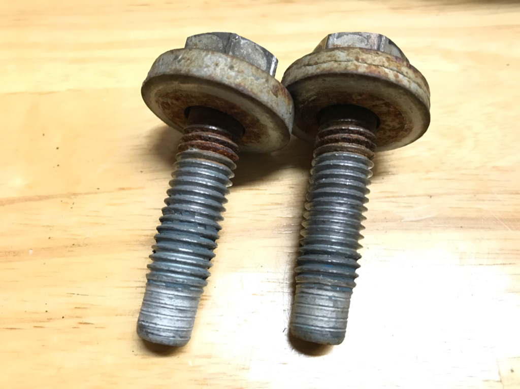

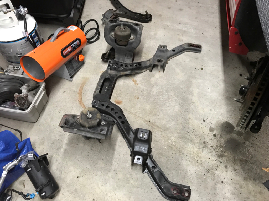

When it comes to the K-Member, brace yourself. The two bolts in each of the long ends are no joke. My 1100 ft/lb Air Cat impact driver was stopped dead and I had to use a large break bar. The metal seemed to screech as I removed them. Some have said they reuse the bolts. I absolutely will not. It’s a small investment when you are this far into it. Protect yourself and do it right.
There isn’t much information about removing the antenna so you can remove the quarter panel. The information I did find was ambiguous or incorrect.
Attacking the antenna cover with force is wrong. Simply stick something under the cap from the side or opposite side marked. Do not do the ends. If done correctly it comes off so easy, I can actually do it with my thumbnail.
My last tip of the day is that when removing the front fenders, you may be the “lucky” one with rock hard sealant in the bottom that won’t let go.
It took a chisel and a bunch of hammering which now means I’ll have to weld it up and prime/paint.

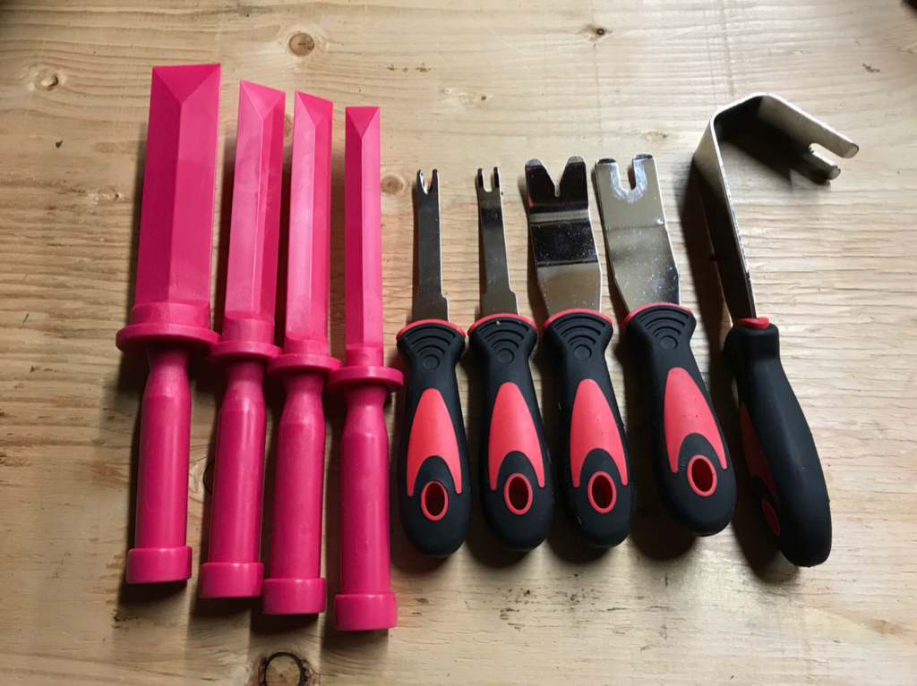

I then found two great sets of tools at harbor freight (a little late I know), but the metal set (which I used on the other side) is great for pulling the tree plugs for the side skirts as well as unlatching the hidden clips, and the neon set is a super hard plastic scraper that would have worked perfect.
I’m getting closer to welding up, smoothing, and painting the bay.
I think I am going to go with Ferrari’s Rosso Corsa 322 in solvent based Axalta.

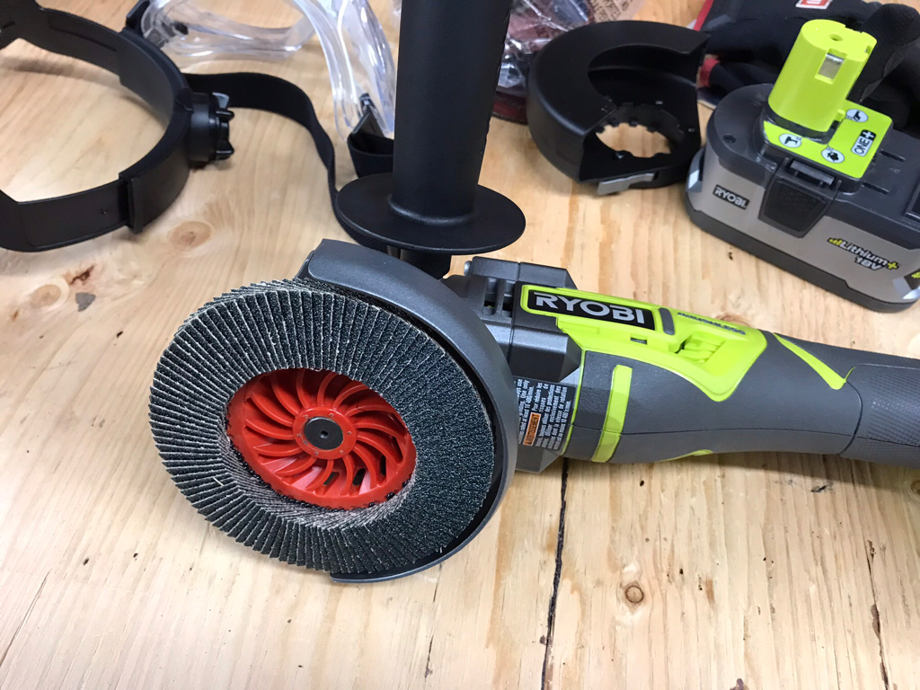

I picked up a neat little Ryobi brushless grinder/cut-off tool and Diablo flap style disc. The Evap mount was welded in 3 places, but this made short work of it. It’s perfectly smooth so no weakening of the metal.
