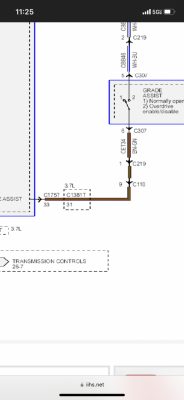

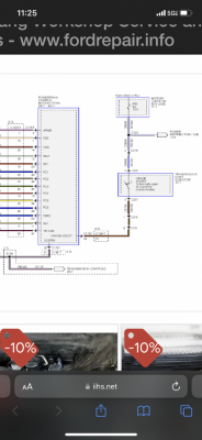

Correct me if I am wrong, but I had narrowed to the wire Brn/Grn being for a select shift but for 6r80. Has anyone with a mt82 11’ had this wire in the connector coming off the fuse box for the transmission/power steering harness?

Yeah that too. I just don’t know if its causing the issue of the car not firing . Compression test was good, timing is good. Fueling is good

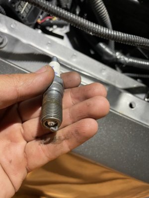

Wet and not one sign of it ever been fired. Brisk Silvers
So potentially fouled out by now trying to start this.
