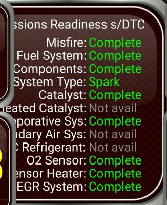

I have never seen "system type=spark" on mine, and you have 9 active monitors. hmmmm
But you just confirmed what I have been observing, drive cycles per Ford mean didly when it comes to a 2013 mustang. lol And the closer to zero the fuel trims are, the quicker the tests complete.
What is your OBD switch and MIL switch set to in the tune? (stock tune has it a 183 for both, and that gives me 8 monitors.)
I honestly have no idea. It's not something I've ever heard of before.
