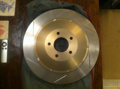

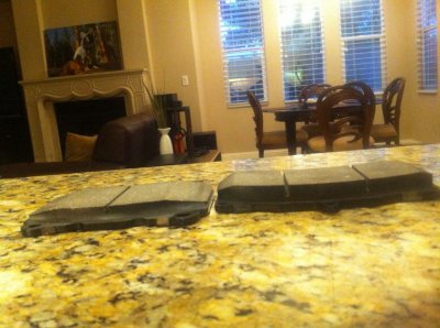

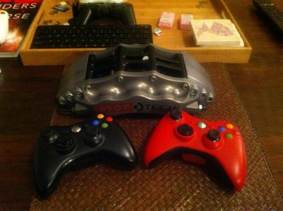

I thought this may be of interest. Below are pics of the stoptech kit. 15" rotor with an aluminum hat and 6 piston caliper. Note the pad difference between 14" OEM brembo and the stoptech. There seems to be a noticeable difference in the height of the pad, however the taper at either end of the brembo pad seems like it reduces a lot of the contact patch.
