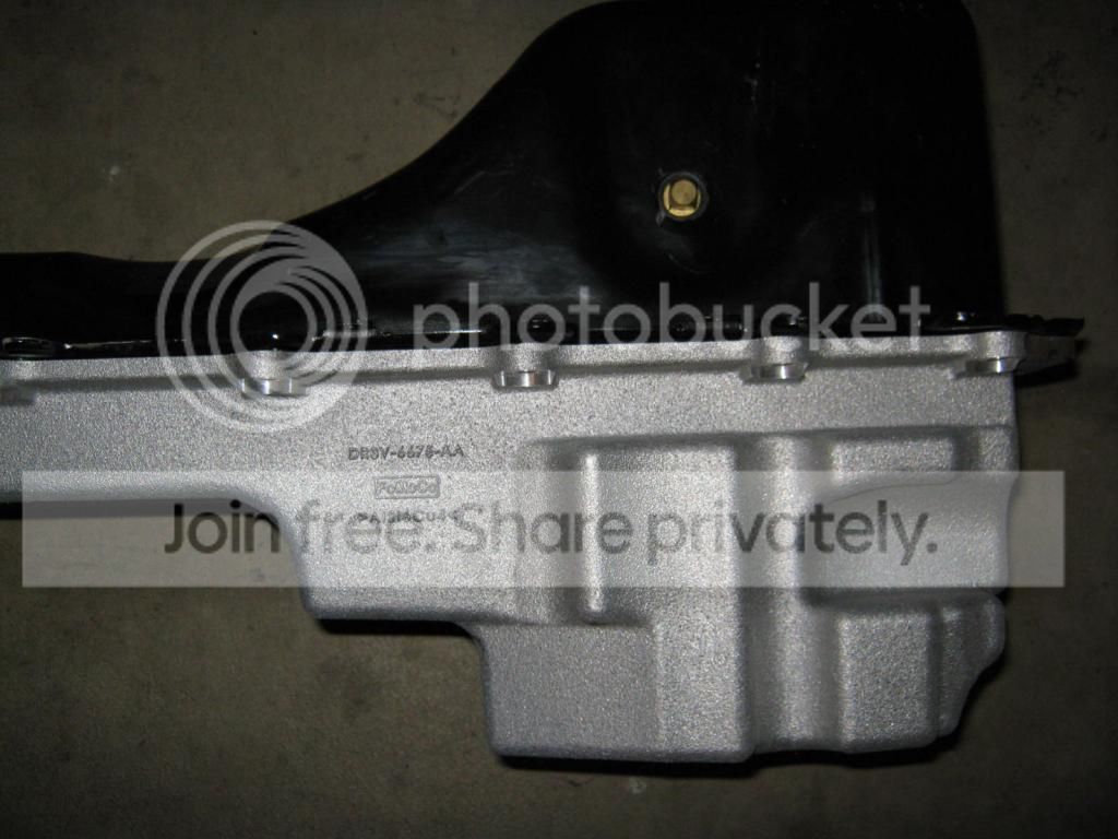

Hey guys,

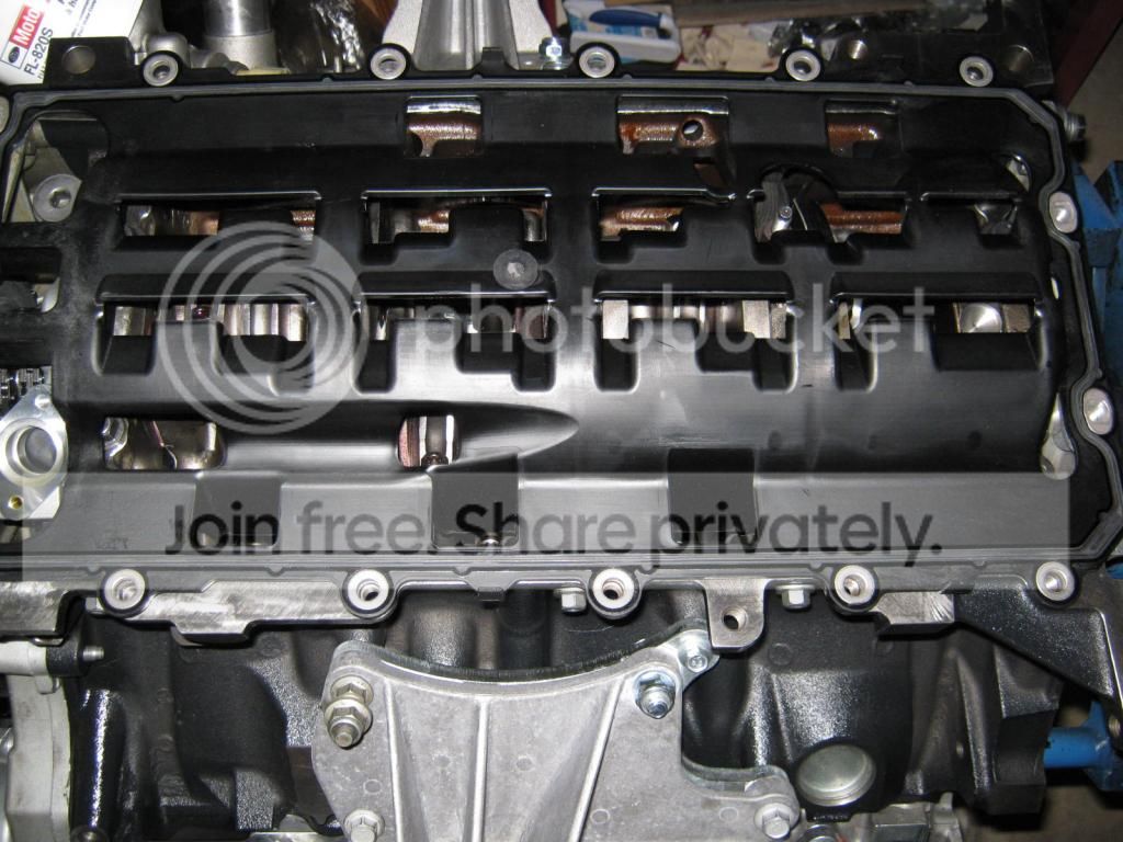

I installed a GT500 oil pan on my new motor and wanted to show everybody exactly where the windage tray needs to be clearanced in order to fit properly on the 4.6. It's very simple since the material is hard plastic. I used an angle grinder with a metal cutting disc but you can use a Dremel or even a hacksaw.
As you can see the front rib needs to be cut to clear the two bolts on the crank. This was the only modification I had to do in order to install this pan.
It comes with all new bolts and the pan is cast in such a way as to give you plenty of room for your ratchet and socket when installing it. There's cutout grooves which line up with each bolt hole and my ratchet fit perfectly without having to go crazy with swivels, etc.
This oil pan is part number M-6675-MSVT and is available through Ford Racing.

Sorry if this is a stupid question but will the windage tray work with a stroker crank?

Yes it will. I used the same frpp kit on my build and it has a 3.75 stroke crank. Keep in mind that it's built for a 5.4 with a much longer stroke. 4.165" iirc.
If you use non 3v main cap bolts the mod won't be needed because only one of them has a stud sticking out and the tray is built for that stud.
This is from my Big Bore Boss block. It uses a main cap setup that is similar to the GT500 or Terminator blocks.

Can you take some pics of the side of the pan and the front of the pan up close? Trying to decide if there will be a good place for me to tap for a turbo drain.

Looks like Bruce has you covered. Here's a couple I just took while laying on the garage floor reaching in under the car.

right below the balancer just like my stock pan. and with this you can actually tap the hole properly due to the thickness.
