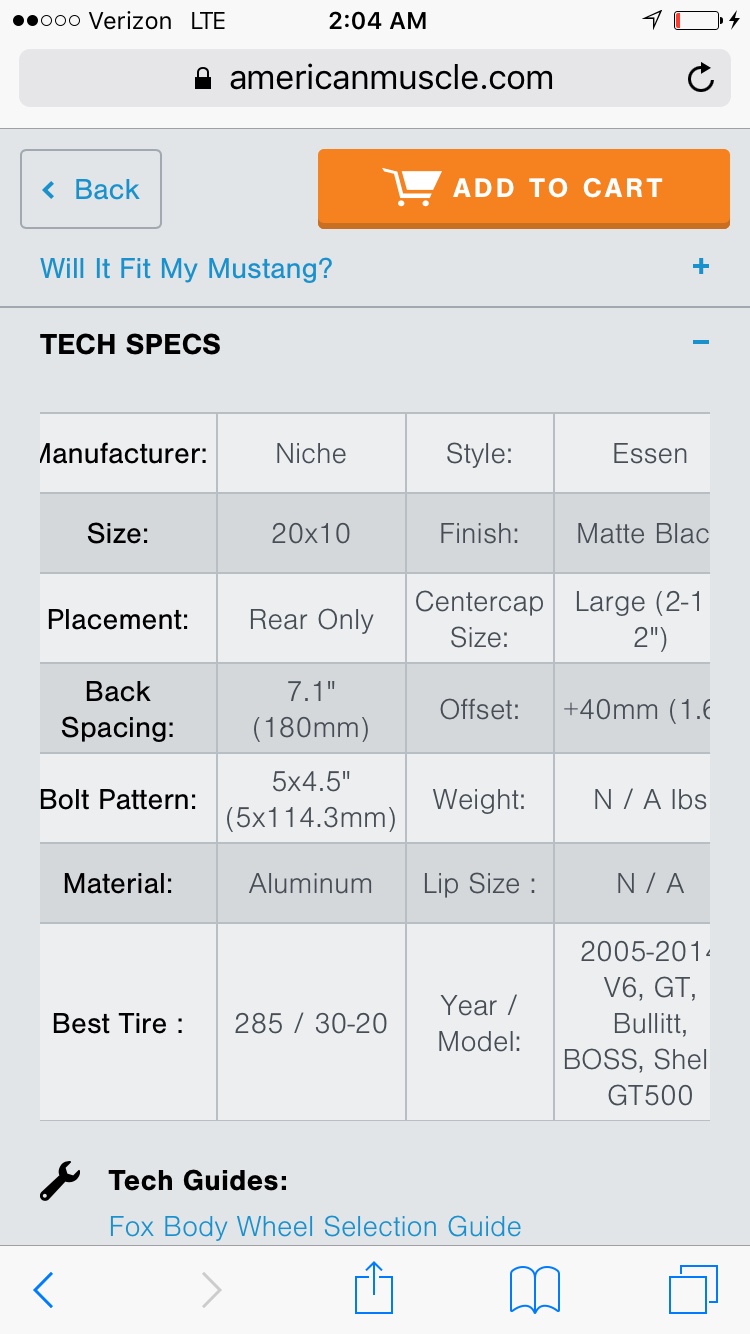

Hi everyone I am brand new to this so I apologize if I did not post in the right area. I have a 2011 Mustang GT and I would really like to put these Niche M147's on. Only problem is I really like the deep dish look and I hate the way the staggered front wheels lock so I would like to get the 20x10 on all four corners here are the specs not sure if anybody has any experience with these dimensions on their S197 but any help would be awesome. On the website it says rear fitment only thanks again

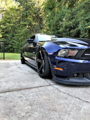

This is my 20x10 squared with a +40 mm offset. I am having to run a 12mm spacer up front to clear the Brembos I have on here but it can be done. Tires are 275/35/20. The main reason they say fitment in the rear only is due to the concaves of the front wheels mostly not clearing the brake calipers. IMG_0123.jpg

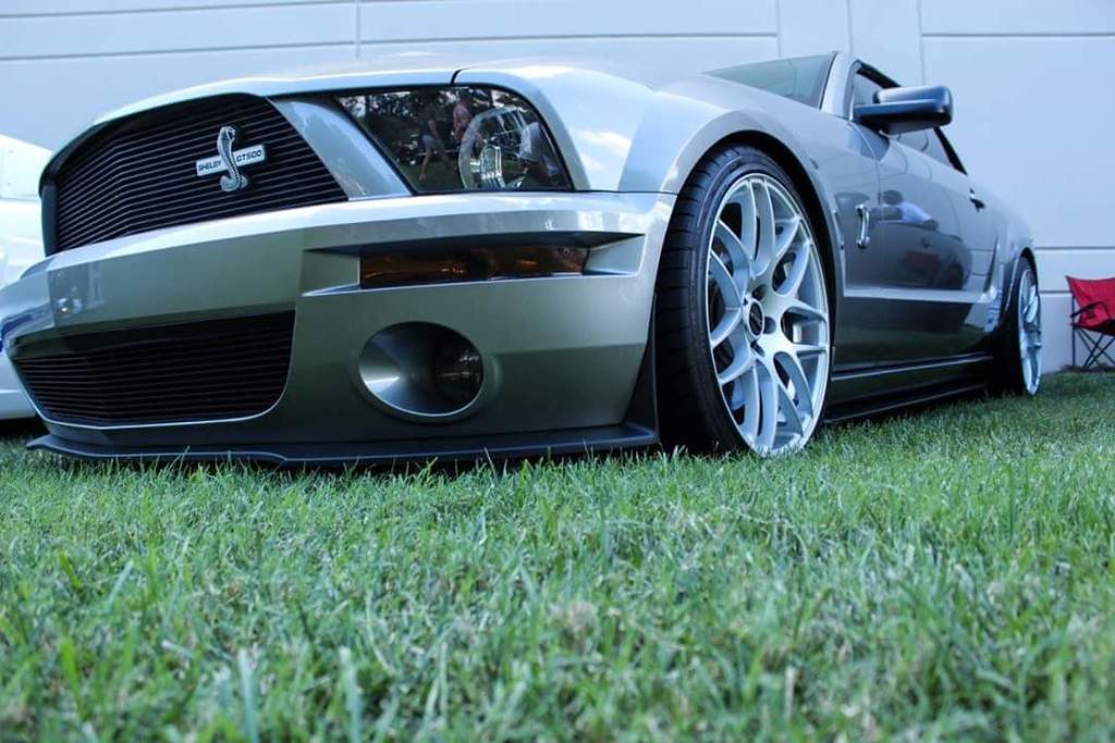

If the M147's are shaped like the Milans, the 20x10 with 40mm offset will fit perfectly.
I had the Milans with that exact size/offset, and I had tons of room between the wheel spoke and the Brembo caliper, and plenty of clearance against the strut too.
This was with 275/35/20 Nitto 555 G2 tires:
I'd still have these wheels if they didn't fit so flush in the back though.
I had 305/35/20 tires on the back and because of the bulging sidewalls and aggressive offset, the tires were hitting the fenders over bumps.
Had the same tires on a different set of 20x10 wheels and had no rubbing issues, but those wheels had a 48mm offset, so they sat further in.

Car was on Steeda Sport springs at the time, with 05-09 Koni Yellows, GT500 strut mounts, and the extra weight of the Whipple kit on the front. The whole combo probably sat about a half-inch lower than the springs would've normally been rated for ... so probably 1.5-1.75" lower than stock

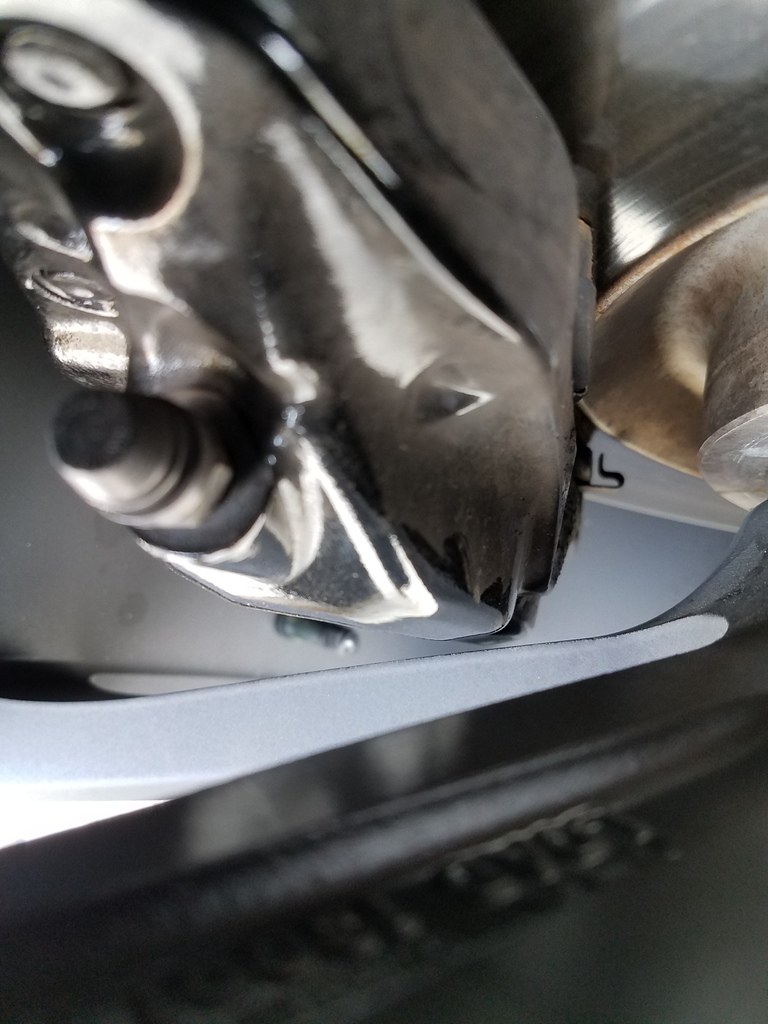

20x10 +40 concave Niche wheels here as well, but running 285/30-20. Also need to run a spacer as Kipp07GT mentioned.
Love the look
But clearance is tight to the caliper

I can't say without the brembos. Your calipers won't be as wide, but they also won't push as far out towards the barrel. The closer you get to the barrel the more clearance you actually have. I think that with the 6 piston Brembos from the 2013-14 GT500 you may actually be able to get away with no spacer or a very mild one.
