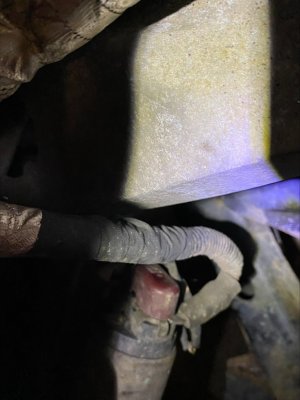

There is a single black wire, with a connector near the BEC. Thata the one that triggers the starter.

Starter works when I jump it. When I jump it with key on it cranks but makes no attempt to start. I can hear fuel pump prime. I have a cheap scanner from a parts store and there are no codes. Nothing flashing on the dash. I can only guess it's something to do with PATs. I guess I will look into getting FOREscan
