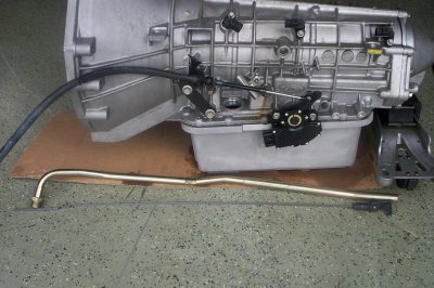

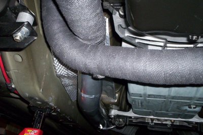

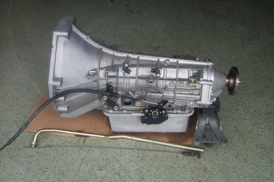

here's a few and a couple show a few of the turbo pipes...the right two are the stock auto
GI Joe
Apr 10, 2007
3,122
9
hopefully it is of some help...

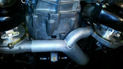

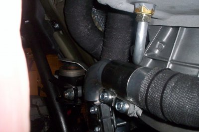

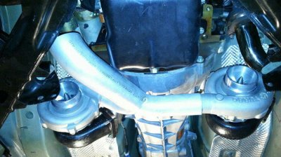

I'll show you where I think I'll have clearance issues and give me your input. These pics are on a 6060 transmission and I am trying to determine if the piping and turbo's will clear a 4r70w
Sent from my SPH-L900 using Tapatalk
GI Joe
Apr 10, 2007
3,122
9
well the two pics of the tubing under the corner of the oil pan looks like they would clear. You can dimple that if you have to. Its so close to the flexplate area, as I said earlier. I cant see how the 6060 tranny could be any bigger...after all its housing just the flex plate. The area that tough to tell is the one down pipe going in the AR of the passenger side turbo The 4R70 could be wider there. not saying I think it is wider, just saying tough to tell on that one. Just bolt it all up and bolt it from the other end and if it don't fit get the pipe extended. One thing about a turbo you can always have the pipes modified.
