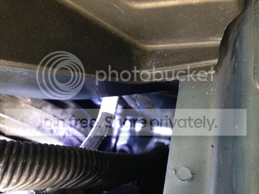

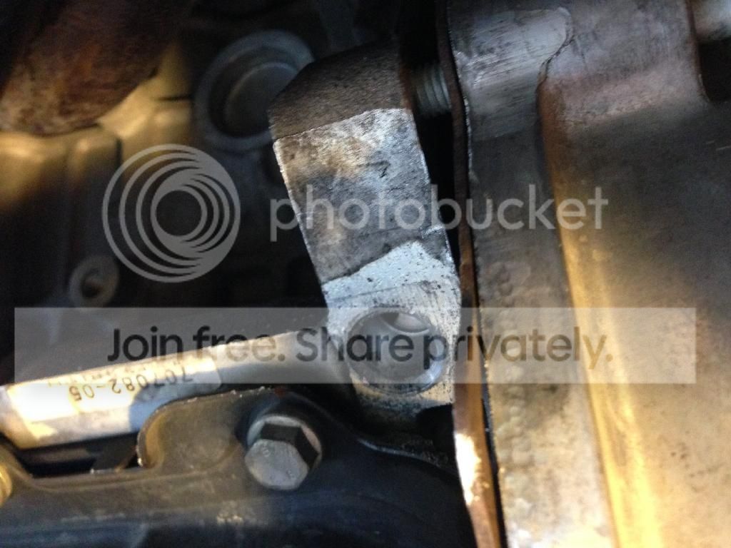

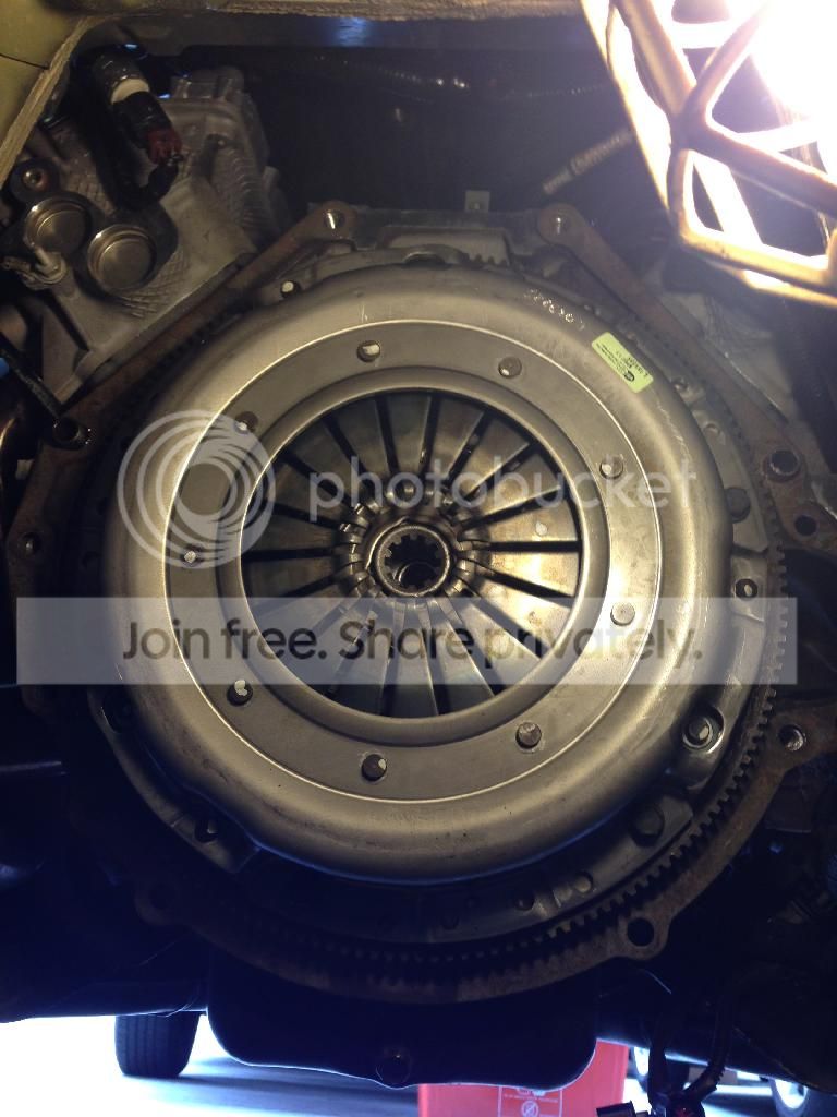

Drained the fluid from the 3650 and replaced it with fresh before I install it. I Installed the pilot bearing/flywheel/clutch/pressure plate and went to put the new transmission in but I am having clearance issues. Trying to line the motor up with the trans is a pain in the ass. My long tube headers are stopping my motor from tilting enough to where I can slide the transmissions input shaft past the pressure plate fingers. The side of the trans where the throwout line comes out of (driver side) is so close it is pressing up against the body of the car.. I got pissed off yesterday and decided to stop. Hoping for next saturday to start working on it again but with the help of a few stangforce members.
Torque specs for the flywheel ford says anywhere from 59-64ft lbs, and the pressure plate they say 33ft lbs if anyone ever needs to know.
Here is a not so great shot of why I am caught up. Didn't want to have to remove the long tube header =/..

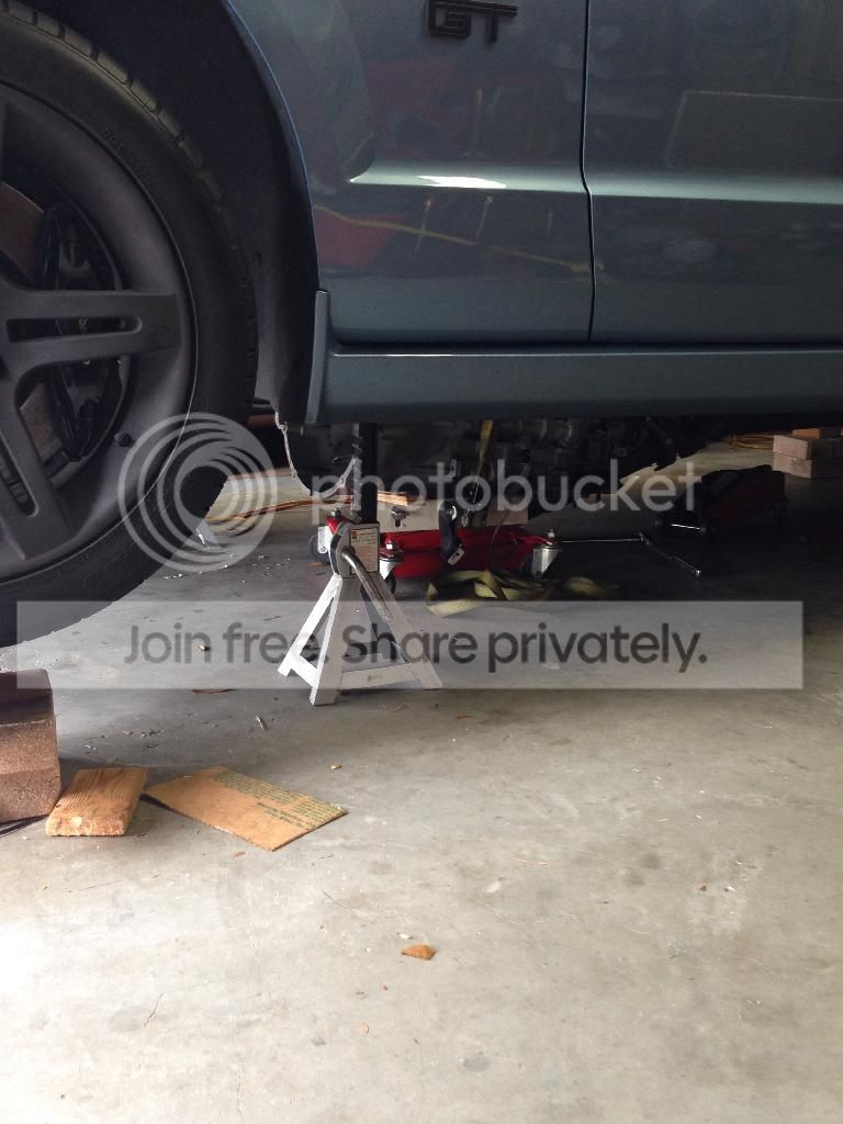

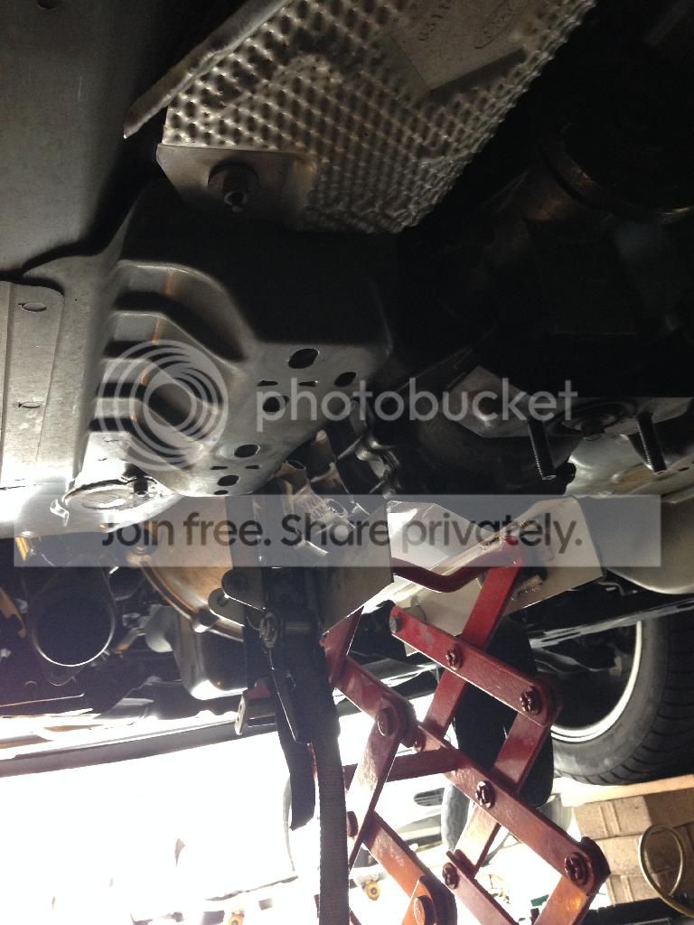

By jacking up the front of the motor just a slight bit and sticking a good inch or so of wood under the front of the tranny on the jack I got enough angle to get the transmission to mate with the motor. There was a little over double the amount of wood in this picture.

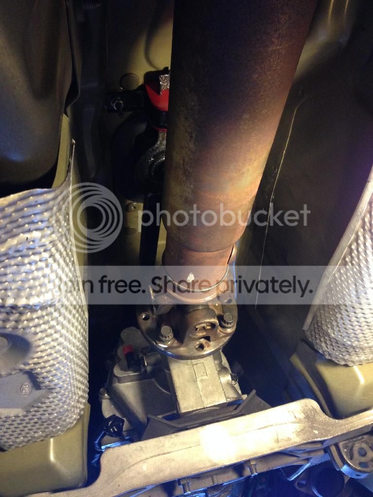

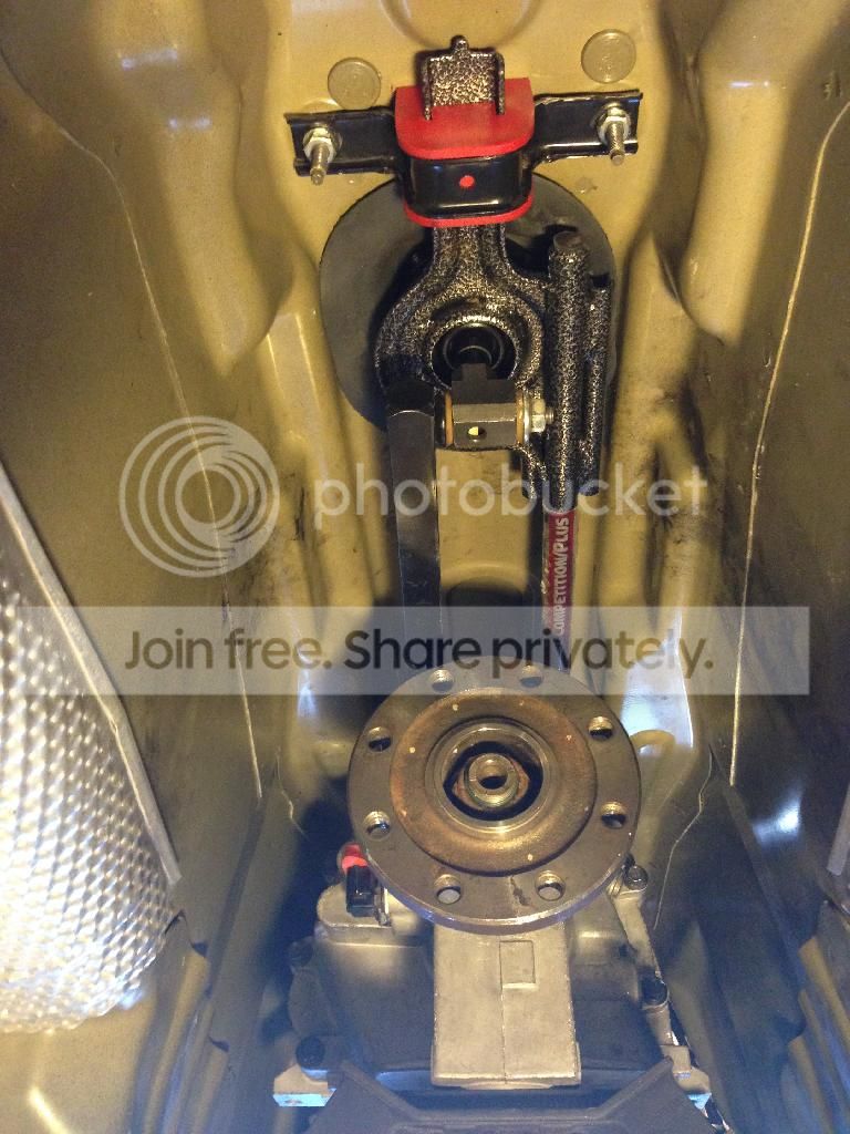

Got around to tightening the bell housing bolts, installed my starter, the exhaust shields, O2s, full exhaust, and driveshaft. Car is 99% done.
Had a little trouble sliding the trans completely flush onto the motor so instead of struggling with it, I threaded all the bolts in and gradually tightened each one little by little so it went on straight.

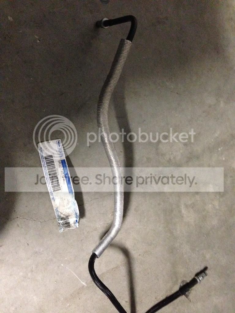

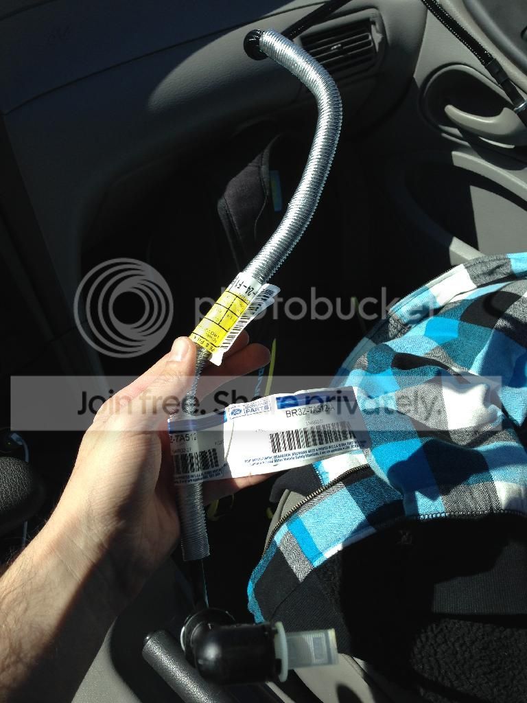

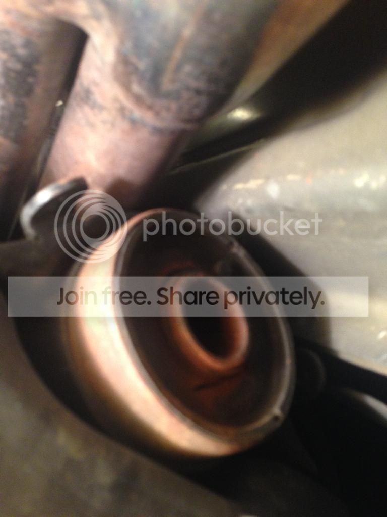

Went to install the last piece to the puzzle (hydraulic clutch line) and the piece that is circled in the picture below IS NOT something I have.. So I had to stop for tonight and didn't get the car running. I have to go to ford tomorrow after work and see if they can sell just that piece or if that is part of the clutch line i'll just buy a new one.
6R3Z-7A512-C (Original part number) but was replaced with BR3Z-7A512-A.. <== I have this and it's brand new but it didn't come with the piece I need. Time will tell! So close!

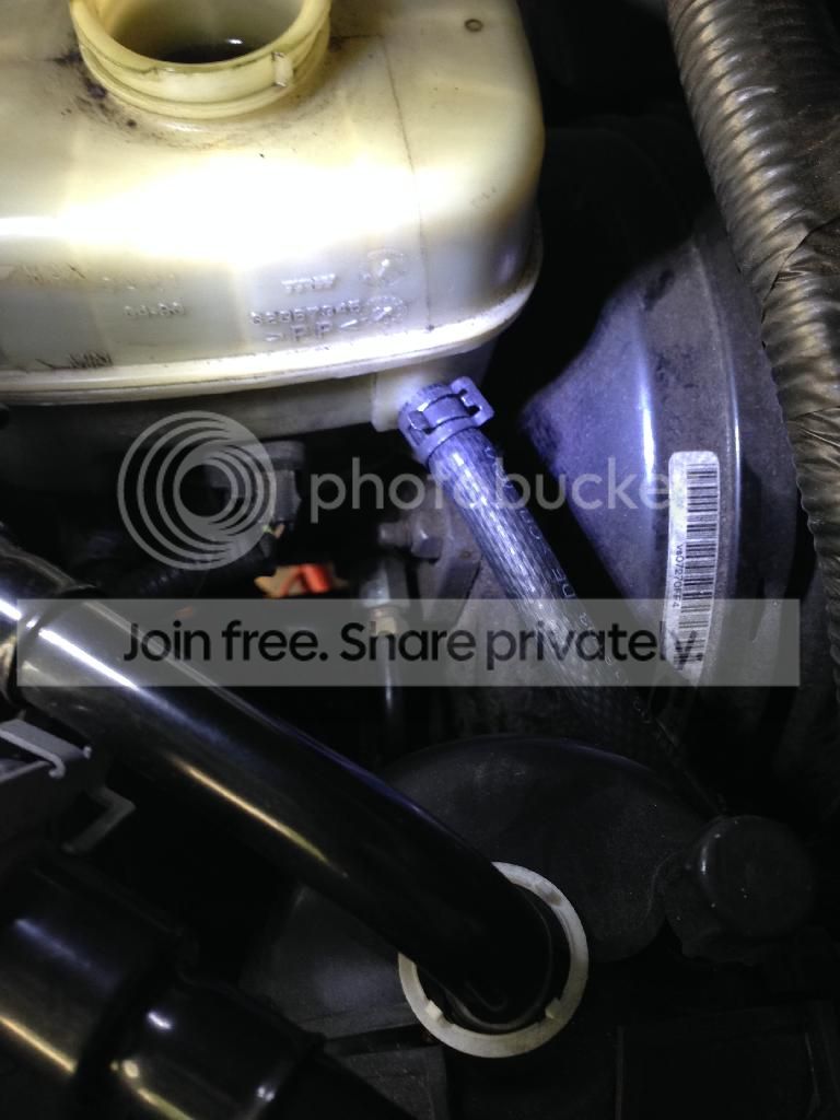

I called Ford yesterday on my drive home from the hospital and had them order it for me. Grabbed it today after the hospital and installed it. Took about 10-15 mins to figure out the best way to route it and then once connected I bled it and its got great pedal pressure.
Shitty part of this all is I go to load my tune from VMP Tuning onto my Xcal2 and he sent me a .cef file and not a .ll3 file and I don't know how to load it, if at all possible. That is the only thing holding me back from driving her for the first time as a manual right now =/..
Bleeding it, took no more than 5-10 mins..

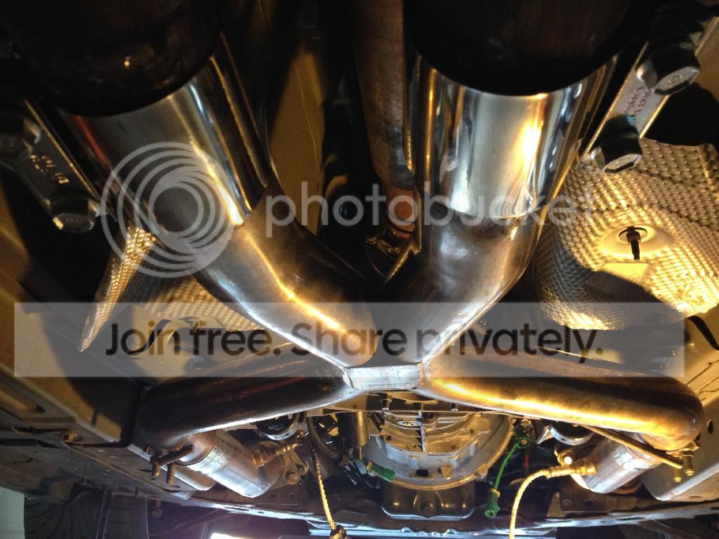

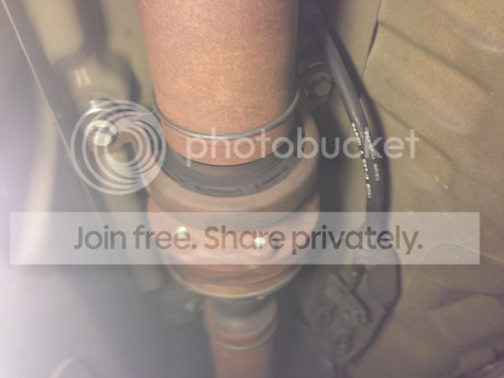

Anyhow, initial fire up- started up great. No CELs or codes, took her around the block. Felt pretty good, but unfortunately something was not plugged in as my speedo does not work.. Have to figure that out next.. Since I destroyed the clamps b/c they were welded, I had to buy replacements and it has a massive exhaust leak =/..
Parked it, looked at the car b/c I smelt a slight burning (not clutch) just like if you were to install a new exhaust and its burning off the coating.. Sounds really odd when driving it b/c of the leak. I think the car is fine though, it shifts smooth as can be. I think the tune needs some adjustments. Second fire up, started driving around my neighborhood and I get a CEL for P2195. Almost like the car lost power and it almost stalled out on me. Took it home and parked it. Going to fix the speedo issue and the exhaust leak tomorrow hopefully and see about the tune.
