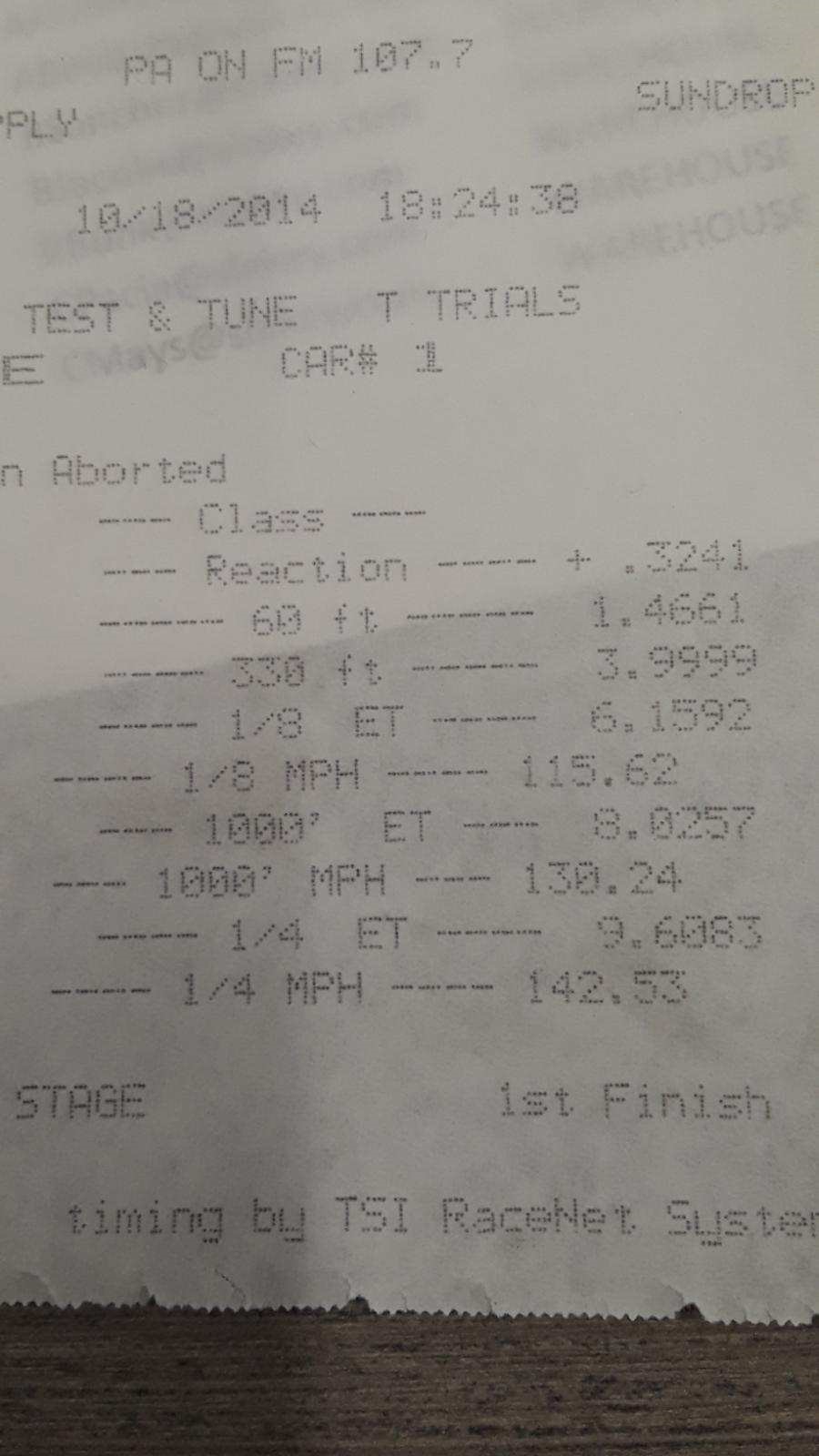

IMO you're gonna need to loose a significant chunk of weight and more than 500rwhp. I am running 5.4's at a little under 130 in the 1/8th, don't recall exactly what my car weighs, but it is still over 3000lbs before driver, and I am making 1200 to the tires. A 6.5 will put you deep into the 10's maybe even a very high 9, I will see if I can dig up a time slip.
5.4's are impressive. I would like to see the time slip. Did you build the car for that et or did you slowly get there?
By the way, I found Terry's build thread. That thread was full of pictures and most are gone. Sadly, I did not get much out of it.

Sactown & ponys197: Thank you
Sactown, At 875 rwhp, I am guessing that you were not using pump gas or a stock displacement 4.6, correct? Can you elaborate a little on your combo to get to that 6.1 ET?
I was running E85 from the pump, I would test the fuel to make sure it was good, fuel here in Ca is pretty sketchy. Ford Racing Aluminator stock displacement 8.5.1 compression (still is stock displacement) single 76/75 turbo air to air, at the time 4R70W mvb, 3500-4000rpm stall, stage 2 blower cams (still running these), ford racing intake and throttle body, full exhaust, LCA, UCA, ARB, 4.10's, a few weight reduction mods, and really good shocks, plus slicks.
I melted the #7 piston a year ago due to an injector only operating at 87%. Had the motor rebuilt, upgraded rods and pistons, now running 10.1 compression, still stock displacement, only run Red Ignite fuel E90 114 octane, power glide, 3.73's, lightened the car up some, open exhaust and radial slicks.
Saving for a larger turbo, some additional weight reduction and a racing brake setup, I would like to run 4.6's, going to take some work to get there.
