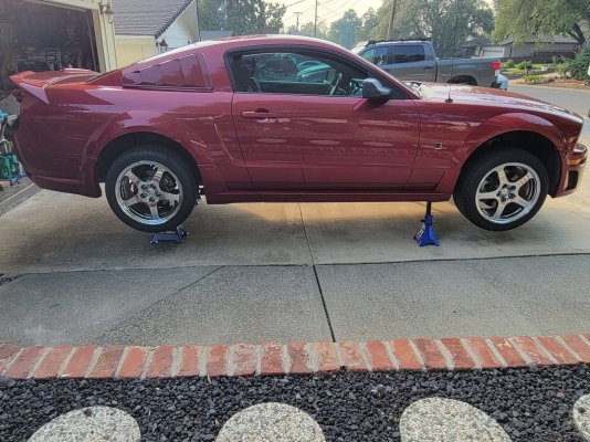

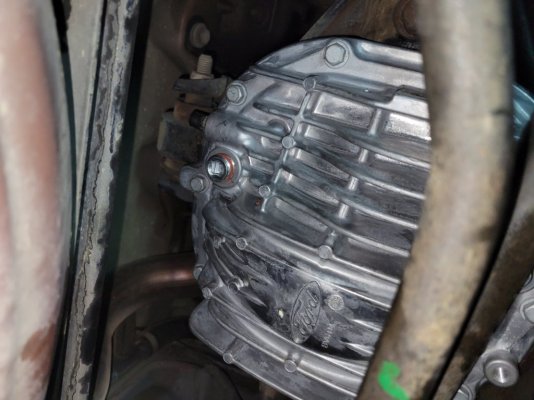

Well I got the cover and Lube locker gasket this afternoon. Put the car up on jacks and went for it. Pretty straight forward. The inside was really clean as I suspected it would be but the oil was black. There wasn't a gasket just a tiny bead of silicone that stayed on the cover. looked like it was a poor job and I could see it had been weeping. Cleaned everything up, moved the vent from the axle to the top of the cover and went for the install.
There was no way that cover was going to fit past the panhard bar. I had stands on the axle so I moved them to the pinch weld so the axle could drop some. Still a no go. Grrr!
Since I had the stands on the pinch welds I dropped the panhard bar from the passenger side. That gave me the room I needed. Got everything buttoned up, filled with lube and hammered the bar back up and it's off about a 1/2 inch. Going to use a ratchet strap in the morning and pull it back in alignment.
Since it's all jacked up I'm going to install some new brake pads I've had for a while. More fun! Wish me luck!
