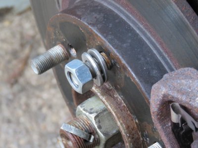

No problem. I installed those same studs in my '08 GT a year or two ago.
When you get around to doing this, use an open-end nut (I think it's 1/2-20) and two or more stainless steel washers with some grease between a couple of them. This is basically Ford's shop manual procedure that I've added the grease to, and specified stainless for the washers because they're smoother than zinc washers. I also grease the studs, being diligent about removing this after with a solvent (I use acetone). Studs pull through (and pull through square to the flange) with only light to moderate effort with a standard 1/2" ratchet.
Do NOT use an impact tool, as this can strip the splines.

Don't remember having to, but it's been a while. I did use a medium-weight machinist hammer to loosen the studs, though. Ford's C-clamp method would require rotor removal.

When I did my studs I used the lisle stud installer and never took my rotors off. There is a small slot in the back for knocking them out and putting them back on. Took all of 5 minutes per side. Best money I have ever spent on that installer. It takes the load off the studs.
