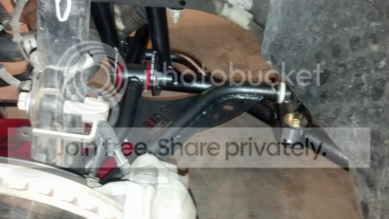

Installed my new red A-arms & support over Christmas ! !
too bad I can't get it aligned until Monday (Ughh)
more photos to come when it is on the rack at the ailgnment shop
