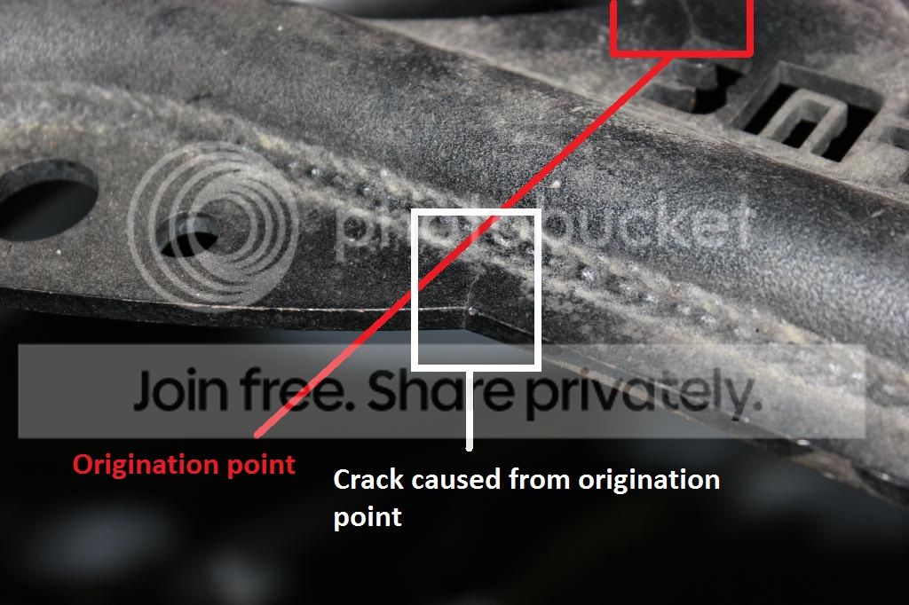

Why not use tubing instead of gusseting to connect the tubes? Doesn't make sense to me. I understand you're looking to save weight but at the sacrifice of strength? And why would you put a sharp corner? Stress concentration....
Because it is not practical on the S197, as it is with other platforms. These style arms need as much "coverage" as possible. We manufacture A-Arms for 9 different platforms - and the S197 is unlike any of the others. As a matter of fact, that can be apparent by everyone "knowing" how they should be built, but, only 2 company's produce street-able aftermarket versions (compared to almost 20 for 79-04 Mustangs). Anyone can build a traditional style A-Arm, not many can successfully build an S197 A-Arm. :thumb2:
Correct, sharp(er) corner's allow for higher levels of stress concentration.
That said, the previous "sharp" corner....in the scheme of things, really isn't that sharp. We revised it, simply to throw out any future gusset concerns, but I have 100% faith in the "sharp" design, assuming the center gusset does it job.

You have 100% faith yet you have part failure that clearly originated at the sharp corner...... Anyone that would purchase the old style is a fool.
We have zero confirmed failures that have "originated" from said corner.
Again, there have been zero. Not one single BMR A-Arm has failed due to said corner - the origination is always the older style center gusset.
There are over 1500 "sharp" cornered sets of BMR A-Arms on cars as I type this. 1500, not 15...or 150.
Please read and comprehend my posts before muddying up my thread(s), as you so commonly like to do.

Then where did this crack originate? You even posted up the picture of the failure.... that's why I'm so confused here.
Granted, and I know this as well as anyone else, this failure was induced under extreme loading conditions that 99% of your customers will never put their parts through. I'm just saying you improved your design significantly by removing the sharp corner and introducing a round at that location. My question was why not just add more gusset material to that area to increase strength?
It was caused by the center gusset being compromised by the crack. I made a picture to help explain better. I apologize, I may have been able to express this more clearly. This specific incident was confirmed. The center gusset crack was present BEFORE the sharp corner crack - for a few months, actually. We have never seen an arm with a crack at that corner, and not a compromised gusset. I hope this clears things up.
Because it is much harder than it sounds. This is where people who see pictures, simply do not understand some of the reasons behind our design.
Example. Due to our latest design A-Arm....wheel clearance has been compromised now. At full lock, the odds of the wheel hitting the gusset are now much greater - especially when the customer has wide wheels up front...or inset wheels, etc.
Here is a picture of said example. This is a BMR/Griggs set-up road course car.....with the current version BMR A-Arms.
I assure you, we don't just throw stuff together and ship it. There are many reasons behind our decisions. No offense to anyone reading this - but, it is extremely easy for people to look at these occurrences on a computer, and feel that they know how to "do it" better. It is similar to when I watch my favorite football team playing on TV, and cuss Romo for being an idiot and not hitting an open receiver.
We are not perfect - no suspension company is. But instead of accepting our designs, we are ALWAYS looking for ways to improve them - regardless if the only issues are on race-cars, etc.
I meant what I stated previously - there is a very good reason that many companies have tried to make these pieces over the years, yet only 2 companies offer a version that is street-able (the other company, has a higher failure "rate" than ours, btw. Way higher..). They are a tough design to "perfect" based on the factory design and clearance issues.
