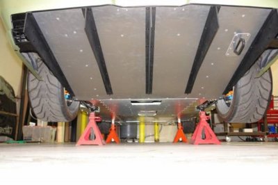

Now That's a belly pan!
Thanks! I haven't seen any pics of the pan on the Hunter. Of course, having no rear exhaust makes the diffuser is a good deal easier to manage.
Last time out at Putnam was my first time there. On street tires I managed 1:25 and on NT01s I recorded a best 1:23. I had tons of data acquisition trouble, so I lost several runs. I like to think I did better than that as I became more familiar with the track, but who knows.
This was also my first time on the R-comps, and I don't think I had the car tuned well for them. There was a host of other braking issues, embarrassing driver issues, and such. So I don't think this is a fair bet at what the car or I can do there, but it is what it is. I'm happy with the time given all the mitigating circumstances...and very much looking forward to coming back and trouncing that time.
