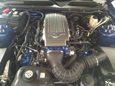

Install Ford Racing 5.0 Coyote Crate + Control Pack + TR-6060 transmission into my 2009 Mustang GT

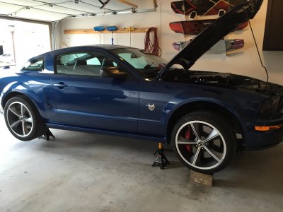

The car today:

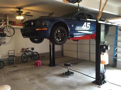

Sweet new lift I installed in my garage last week to make things a bit easier:

Curious if you checked the concrete thickness before lift install?

What did that lift run you?
Was right around $2800 shipped. I went with the Triumph C-7000 from national auto tool: HERE
It is portable so I can unbolt one of the columns and move to the side of the garage when not being used. So far it's pretty awesome, might be the most enjoyable tool I have ever purchased!

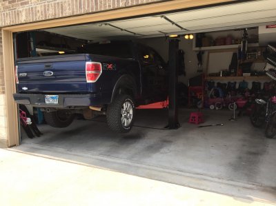

Here's another pic of it holding my 2009 F150 FX4 supercrew:
It honestly didn't show 'any' signs of groaning whatsoever with the truck or the mustang.
Do you even.....lift?
Bro. I don't even lift.:party52:
Yes sir - I was actually pretty sure my concrete would not be thick enough and was planning to cut and pour new footings where they would be bolted. The spec requires 4" and the way houses are made in central Texas these days.... I had no delusions of quality LOL. I just took a 3/8" hammer bit and about 6" from where I planned the columns to be located I drilled a pilot hole starting at 4" and then stuck the depth stick of my calipers down the hole checking for solid bottom. I got to 5" and ran out of bit length on my 3/8" so I figured it was good enough. I had to use 1" hammer bit down to 4" depth on all the lugs and I checked the bottoms on each of them - all rock solid so should be good to go!

I want one of those lifts!! How much room u got to have from the floor to the ceiling?
I know i saw the maxjax lift and it clears 8ft ceilings but does this one!!??
Nutter281
Mar 23, 2015
136
Central Texas
Hey Eddie - looking to sell it as complete long block for now but if that doesn't work out if consider parting it and selling the short block separate. Just seems like a shame to part a perfect low-mileage engine but who knows.
I've got 10ft ceilings in my garage and at that height the roof of the mustang is pretty close to the ceiling but I can walk under without having to tilt my head too much (I'm 5'11")
I looked at the Maxjax too and was going to buy it before finding this one. Two things sold me on this over Maxjax:
1. This 'can' go to 72" should you have the ceiling to support it - which is nice.
2. This has a ratchetting steel safety catch every 3 inches so your car doesn't drop should you blow a hose while lifting and gives you way more flexibility on the resting height of the car. The Maxjax has a safety bar that gets put in place after you reach desired height but no auto-safety on the way up. Also, only has two height settings from factory (though one can easily drill a few more which is what I would have done).
I think either would be awesome - like I say, most enjoyable tool I've ever owned. Like, just bored on Saturday so I lifted the mustang to fine tune the geometry of my long tube headers and h-pipe system interconnects that were previously unpleasant to access on jack stands. That kind of awesome :)
