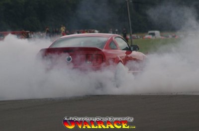

Just a quick haze :thumb2:
picture.php
No really...Do it this way only if you're mad at your tires....

Watch the first few seconds. Notice the tach. PG trans, so when I shift that is equal to 4th gear. LOL. I am a very angry person.
picture.php
LIES! You just hit mach one. That is not tire smoke it is your car moving moister/air at a high rate of speed resulting in a sonic boom...
