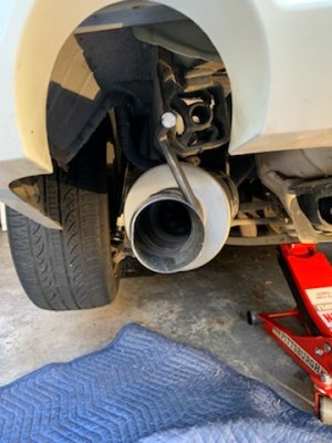

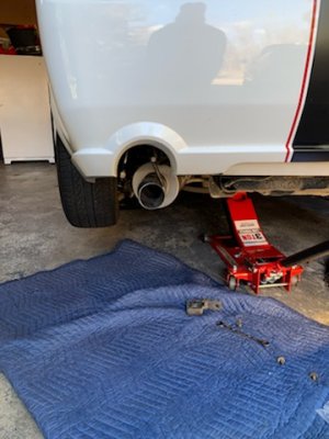

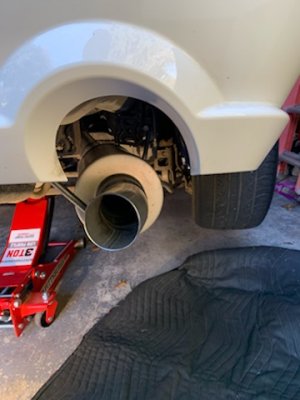

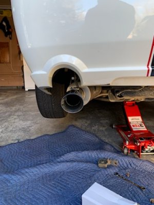

Purchased 3 axle backs from american muscle msrp & s something none fit any suggestion!

how about you also be more descriptive of the fitment issue...

This needs to be answered first, assuming this isn’t a troll post. One not fitting could be a defect, three points to something else.
Photos of the underside of the car would probably help too, showing the hangers and the over-axle pipes.

Hangars on the frame installed wrong? Looks to be 90* off to me.

Are the tips clamped on? If so, I don't think the muffler is correctly oriented to match the hangers. I think that you may have to try and install the hangers and muffler, and leave the clamp to the H-pipe loose. You will probably be able to line it up, or see where you have to do some adjusting. I'd take the muffler tips off for now, as they may be impeding your install.

His mufflers are on the proper sides. The orientation of the tips are properly angled where there supposed to be. It's his hangers on the frame that are on the wrong side. Switch the hangers and the mufflers should line up correctly.
