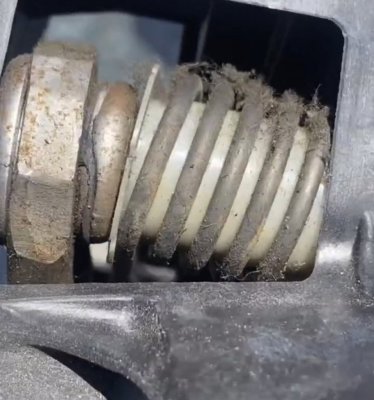

A6420E24-950B-416E-BA4D-9BFFDB74DE88.jpeg I just recently purchased a 2012 Ford Mustang GT Premium, it has come with a multitude of issues.
One of which being the clutch pedal being crooked to the left, which I believe could be causing the issues i will now state.
jVhpk3F
Whenever I shift at high RPM’s, the clutch pedal will stick to the floor, and i will be unable to go into any gears until i lift the pedal off the floor and push it down again. That or it takes an extra 3 seconds to shift.
Cruising around its perfectly fine and normal, except for when the clutch pedal kinda gets hung up when its -almost- at rest, then it will go back into position.
Another issue I’m having is grinding it 4th above 4.5k (gets lower on cold drives) I have to wait to shift or it will grind.
If Im doing donuts or anything high rpm, my clutch will stick half way down AS WELL AS not have full braking ability. It will feel like theres no pressure and i wont be able to stop quickly.
And then there’s other issues such as my differential not acting like a LSD all the time (worn clutch packs?) and my AC vents clicking upon start up or when I change to certain vents among other things.

You have a worn out clutch. Keep driving forcing the shift and you will have a worn out transmission. (If not already damaged)
The pedal was probably overstresses by the worn out clutch. The clutch/brake pedal assembly is attached to a PLASTIC frame, which more than likley is cracked now. I just had mine out to do the clutch master and could not believe my eyes. Plastic shit.

EFFC048E-63D9-4AF5-87BD-E1B555B5DC0C.jpeg 7277C3E5-7813-4EE0-BD77-E51C2CA2FF97.jpeg 5A394D3D-B9A2-454C-AE36-C7F9687F7CFE.jpeg Update: Clutch Pedal Bracket being cracked and bent is what was causing all my issues.
I was driving home and ran over a f**kin tire iron, got out and removed it from the street and when i returned to my car the pedal went straight to the floor. The eyelet for the clutch master cylinder that connects to the pedal was cracked (plastic smh) and I had to ghost shift it all the way home. Friend at work helped me get a new pedal assembly the day before (knew this would happen) and installed it the next day over the course of 45 mins.
since then ive been able to shift at high RPM’s with no issues except my 4th gear grinding which has been a problem since day one. Thankfully i didnt have to do a whole clutch replacement just the pedal bracket.
