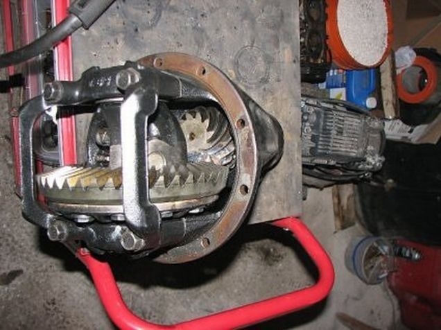

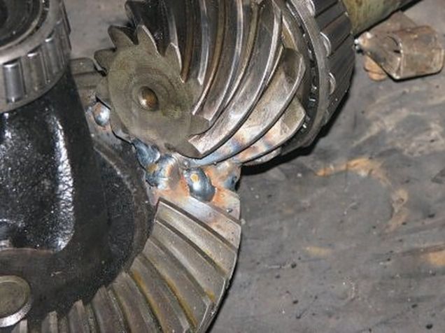

You could weld the diff and make it a spool yourself.
