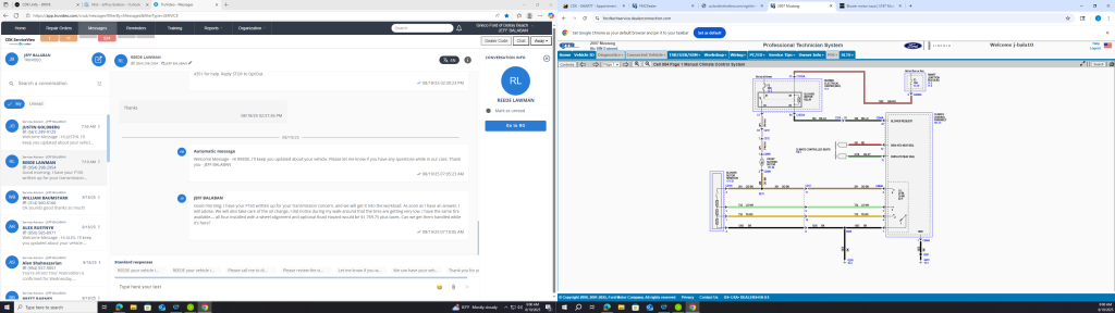

It's not kicking on at all. I just tested the orange/black wire at the resistor. It reads 10.6 volts on speeds 1-3, and 0v on speed 4.
DravenBlade
Aug 18, 2025
Alabama
How can I make that image more sharp? That seems to be my biggest issue is finding the diagrams, but they're all really fuzzy.
