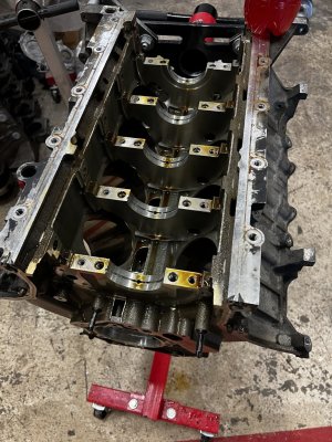

Laga
Aug 10, 2019
999
521
Chicago
I understand i will need balancing for a stock crank but what about machining?, is there a way to get oem spec pistons but forged? (sorry if sound dumb, i really dont know much about this)
I am in the middle of getting my 05 built with forged rods and pistons. I have decided to maintain the stock crank because I’m not going crazy with the boost and it was in very good shape. You will need to have the block and cylinders measured by the machine shop to see what needs to be done. You can get forged pistons from DSS.
