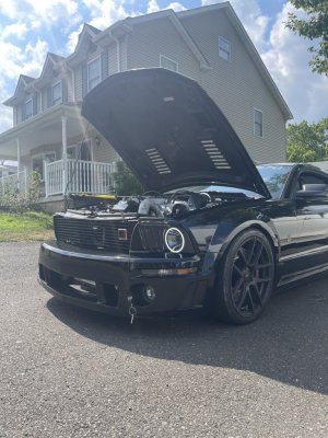

Update 2: Car running good, little notorious 3v cam phaser tick on the passenger valve cover, nothing major, will probably do cam phasers and rocker arms soon or later, other than that, everything runs good, put the bumper, lights and everything else back on. Finally on the road after a year of sitting!IMG_4431.JPG
