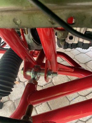

Yes BMR lower arms do fail, this was mine last year, when I contacted BMR they said they had never seen this before. Would not offer any form of warranty. I ordered 2 new ones which in fact when they arrived each weighed over 2lb heavier than older styles which tells me BMR did have a problemBMR 1.jpg
