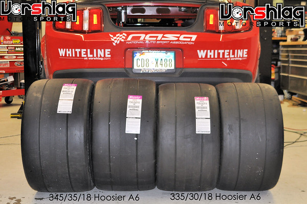

I have 2013 Boss 302 ( all stock except CC plate ) and I am planning to go square tire setup (293/35-18) for the track.
People have gone square on the Boss and they noticed an increased oversteer due to the fact that the stock suspension was setup for staggered tire sizes with 255 front and 285 rear.
So, naturally, I would think putting a smaller rear sway bar will help resume the neutral handling characteristics.

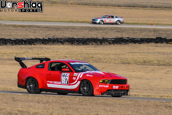

Most "people" who offer up their opinions on square set-ups and handling woes are just parroting what others have told them. And its all bunk. Yes, everyone has a voice on the forums, but not every voice has the same impact, experience, or testing to back up their opinions.
Look, these Mustangs in stock form are designed to UNDERSTEER. Yes, even the Boss302, with the staggered wheel sizes only amplifying that characteristic. The shocks that come on all factory built S197 Mustangs SUUUUUUCK. Yes, even the Tokicos on the Boss. SUUUUUUCK. The spring rates are SOOOOOOOOOFT and the ride heights TALLLLLLLLL. This car is made for the masses, able to ford a stream, drive on gravel roads, and plow through deep snow. Not everyone has those needs so we have an active aftermarket that modifies these cars with lower ride heights, former spring rates and proper dampers. But there are more bad upgrade parts than good - you have to do careful research to find that out, or learn it first hand.
My advice is: don't put too much credence in what factory wheel sizes have affect on handling, or worry about how one change might "alter the sacred balance" of a Boss302 or a GT. These cars are as sacred as an ox cart in stock form. We have tested and proven how these cars go faster and are actually easier to drive on ever wider wheels and tires. The car above, my 2013 Mustang GT, was much better than stock but still a handful to drive with 18x10" wheels and 295mm tires at both ends. Going with wider tires only makes them handle better and easier to push hard.
We have gone from 255mm tires up to 345mm tires and still haven't seen a drop off in our logged data or lap times, from autocross to road course speeds, in our various Mustang tests. Our current set-up has 335mm fronts and 345mm rears, which is a slight stagger but only because the 345/35/18 front is too tall to clear our front flares - if they made a shorter 345mm tire I would have it up front.
We went up from 315mm all around tires in February and dropped 1.4 seconds in back to back tests at the same 1.7 mile track and same conditions when moving up to these 335/345mm tires. So when it comes to S197 Mustangs and tires, BIGGER IS BETTER. We have yet to find a performance tire so wide that it slows the car down... it seemingly doesn't exist for these heavy cars.
And don't fret about what swaybar to get to match with your new wider tires until you drive the car, as it might feel fine to you. Swaybars are not magical - they are just a tuning tool, and a rather crude one at that. It is a hunk of steel with some bends in it, that twists and reduces sway - hopefully. If you have track or autocross aspirations then get an adjustable swaybar at both ends of the car with multiple adjustment holes/settings, and use that to fine tune the handling. Don't use swaybars as a crutch for a weak spring rate, though.
We use the Whiteline bars because they have the most adjustments, a wide range of firmness (that covers both softer and stiffer than any of the stock bits). The rear bar also allows for a wider tire and wheel to be used, because they don't mount like stock and poke right where the tire needs to be (inboard) with an 11" or 12" wheel out back.
