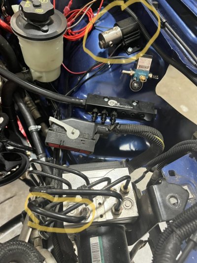

I’m wanting to replace the brake line from the brake booster to the proportioning valve (think that’s what it’s called) but don’t know the size…? I’m adding line lock. Wanting to make a custom line from the booster to the solenoid, then from solenoid to prop valve. Can I use the same style fitting on both ends of the line? In other words, will the fittings that screw into the booster & valve also screw into the solenoid?

If you do it that way aren't you going to lock both the front brakes AND rear brakes? Kinda defeats the purpose, no?
I used a dual solenoid set up on the front brakes only. It's an easy set up and you can utilize all of your stock lines but I opted to swap out for some braided lines.
I have an overhead switch that powers up the line lock and I have another switch that changes the OD button on my shifter to use for activating the line lock.
Edit: My bad, it looks like you meant ABS Module not proportioning valve.

Yeah got proportioning valve confused but figured it out researching lines. If I’m seeing it right, I’m doing it like the Hurst kit is hooked up. Basically putting the solenoid between the prop valve and ABS module. There’s (what I think are) 2 1/4 lines coming from the prop valve to the ABS module…1 for front & 1 for rear. Then 4 3/16 lines going out of the module to calipers. I’m tapping in between the main line for the front calipers.

When I added a line lock to my 2010 GT I put the solenoid valve in the front break circuit between the master cylinder and the ABS motor. I reused the original tube nuts at the master cylinder and ABS motor on the new line and purchased double flare adapters from Summit Racing. If memory serves, the original line and fittings are metric.

original fittings are metric and the brake lines are bubble flares, not inverted double flares

Brake tubing is measured by outside diameter, is it not? Get out a set of calipers or slip wrenches over it until you find the one that fits snug. As others have mentioned, it will be metric.

6mm is close to 1/4” so I think you got it right.
