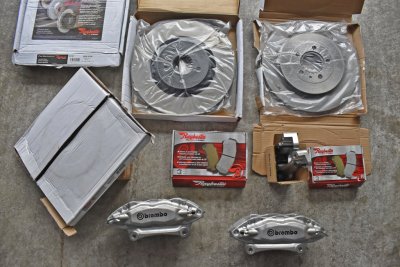

I just completed a Brembo Upgrade to my Base Mustang GT. It was really a self made kit from both RockAuto and Amazon. I had the Base wheels so I used a 20mm spacer in the front. None is need in the back. In the end, I just need a 17mm spacer on the front. I do have Brembo 19 inch wheels in the basement that I might buy tires for later. I am not sure I like these spacers. Parts in all were $550 and I had them professionally installed for $250. All 4 wheels were done with GT500 Rotors in the back.

My hand built kit from Rock Auto and Amazon. Rock Auto supplied the Raybestos stuff. Amazon supplied the knockoff calipers and rear caliper adaptor for the GT500 rotors. Total cost was $550. Because the Mustang had very low miles, I decided not to replace the brake lines.

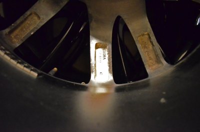

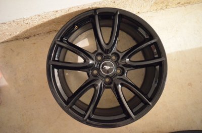

Second question. I rescued these Brembo wheels from the scrap heap at a junkyard for almost scrap price. They are heavy at 32 lbs and Aluminum is going for more then a dollar a pound. They look to be factory powder coated. An option within a option? They also looked a mess but with a good high pressure wash, they now look like new. It seems brake dust sticks to powder coat and there has been several write-ups about that. I am trying to figure out what tires to buy for these. They came with 255/40/19 at 27 inches tall. Base is 235/50/18 at 27.3 inches tall and I now have 255/45/18s at 27 inches tall. What are the biggest tires I can fit and still keep the ABS system happy?

I don't think the ABS cares..... Recommend you go with stock size - 255/40/19. The best part about these rims is they'll fit the Brembo's without spacers.

I purchased from Rock Auto, Raybestos Special Duty rust protected front Rotor 680497 for $38 each and Raybestos Race Rotor 68099OR on sale special for $15 each. That was most likely a mistake by me as the back rotors are not protected from rust. The 680990 without the R is the real mate to the front rotor but they were also $38 each. The race rotors are about the same spec but it's expected they will be trash in a few races going from 150mph to 40mph three or for times a lap. So the rotors do not get a chance to rust. The pads were MGD1050M fronts and MGD1082CH backs. They are a mid grade pad for street use and better then the SG standard grade versions. Pads Rotors and Shipping was a little under $200. Then another $200 for the Calipers on Amazon quick ship. Hell of a deal as no core needed. Then $100 for the back adaptors and $50 for the 20mm spacers. After all said and done, I could have used 17mm spacers and might even work with 15mm spacers at the very minimum clearance of 3.5mm.

Well as I said, I found a set of very ugly looking black Brembo Wheels on a junk pile ready to be sold to a beer can manufacture. I got them for poundage which was $50 for each 32 lb wheel. After the transaction, the guy that sold them to me got into a fight with another guy at the yard saying I had to pay more money. Some junkyard people are meaner then their dogs. The wheels cleaned up like new with a 2700lbs high pressure washer with soap feed. Anyway, on Ebay there are two types of 19 inch tires. The under $100 each China tires including shipping and then the good old Big Brand Name $300 each plus tires. These cheap China tires look great and some can be less then $70 each including shipping. Anyone try these? One name is Lionheart tires.

Not a tire expert but you can also run 255/45/19. That should open some options for you. Pirelli, Firestone, General, Continental, Goodyear, Yokohama, Michelin.
I don't have any experience with the cheap China tires. I just usually go with the mantra of you get what you pay for. That brings up a question however. Given that you just upgraded to Brembo's why would you trust cheap China tires?
BTW, I did the same thing on my car (upgraded to Brembo's). Only suggestion I would make is to upgrade the brake lines to steel braided. You'll get better feel and peace of mind from the change.
Hope the wheels work out. As long as they're the same dimensions as original they should fit the Brembo's without spacers.

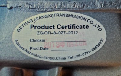

Mostly because most of the Big Brake stuff from both Rock Auto and Amazon was made in China. Only the rear aluminum caliper brackets were made in Florida. There is even questions about these aluminum brackets. So what's the story with these China tires? I do know the story with this Chinese Transmission in all the Mustangs. This company has an office in Detroit. At first they said they were part of BMW. Then they say Mercedes Benz.
LarryJM
Resident Fuktard
Jul 15, 2018
1,008
151
Lots of stuff is made in China. This includes my Brembo Wheels. So why not Chinese tires with my Chinese Brembo wheels and Chinese Brembo brakes being pushed by my Chinese Mustang transmission?
