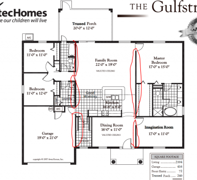

Here is our porch. Much bigger than I thought it would be which is nice! Going to be screened in. That is the door way into the bathroom and the sliding door is just peeking on the edge of the picture.
There's my mancave/office/gaming room with the arrow, and then the big closet and the master bath. Only have 2 walls to go up now. One roughly where the red line is which will separate the dining room and kitchen and then the wall for the pantry which will separate the dining room and pantry.
This is all that's left for the inside walls

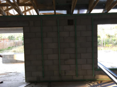

For the walls made of cinder block, do they put in studs still so you can run electric and water? Can't really tell from the pics
CammedS197
Sep 12, 2015
580
33
Palm Bay, FL
Yeah, it's normally 3/4" faring strips but on our house they are doing 2 of them together for better insulating outer walls.

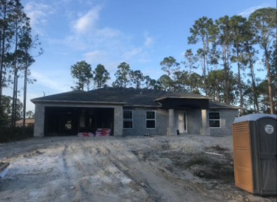

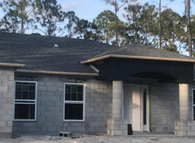

Here's some more views from around the house. It now has tar paper on as of monday and doors and windows go in I believe today.
In the works of buying this lot with the arrow.

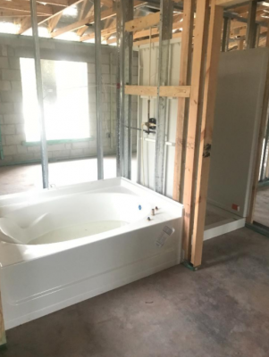

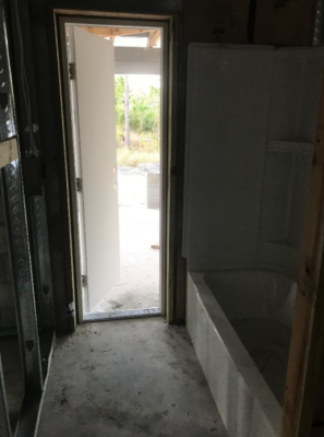

Updates, This is where we are now. Our roof will be finished today 2/12 and on our anniversary. Happy Anniversary to us lol. Also this week insulation and drywall are planned to go in. Doors, windows, electrical is run, plumbing, AC run, and our internal pest control system.
Air Handler
Master bath
Living room with the door and window
