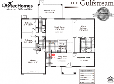

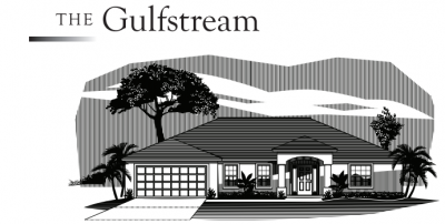

So in June my Wife and I were looking into building a house and talked to many different people for a few months and our dream house was a Lifestyle home and they are very expensive and their cheapest was our max budget for where we lived. They put us in contact with a builder they work with Avtec and when people get too custom and crazy with theirs they recommend Lifstyle as an option. So we talked to them and we instantly left the other home builders. We got so much more for a little cheaper. We love them so far and really help us out. They also offer special incentives for military members which was a very nice plus. Cheaper upgrades as well as a discount on closing costs. They cover a portion of it. It is the Gulfstream with every upgrade possible and everything we wanted. Its a hometown family owned business. I'll get pictures of it soon. My wife has all of them on her camera. We are only at the pad built and the slap staked out with the wood down. Should be poured this week! We are very excited and its also prepped for full solar power if I wanted to install panels. Very efficient house so excited there. Our current rental house is not very efficient. Built as cheap as possible for rental only. Mortgage will be cheaper than our current rent woohoo. Our neighbor directly across the street just finished his and its by the same company and hes got a modified 3 valve. So I'm sure we will be friends.

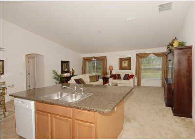

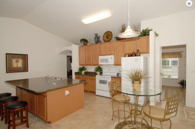

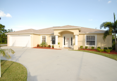

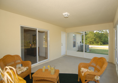

This is the elevation and floor plan and some pictures of what it will pretty much look like when done.

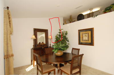

The red there is actually going to be a walkway in our house. We are only losing like a foot and a half on our pantry which is beyond massive. I won't be hurting losing that space. Really opens it up in the dining room.
That's where the walkway where be.

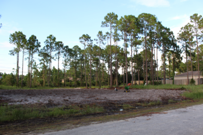

Here I our lot cleared out a few months ago.

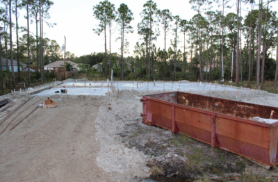

Here is the pad for our lot now.
And last this is where we currently are. The rough plumbing is finished and slab will be poured on the 18th.

Tip: Before dry wall goes up--assume, you will have drywall, ask the builder to let you know. Then go in, take plenty of picture of where the plumbing, electrical outlets and all the wiring that will be covered by the wall. Save these pictures, the will come handy later on. I did that, then wanted to get some ceiling fans installed and other electrical mods. The electrician was able to pinpoint where everything was behind the wall, taking out the guess work. Of course, some may have high tech gadgets to figure all that thing out, nothing beats a pic. At least for me.

Hey thanks on those heads up. We are going by today to checkout the slab. Just got informed that the blocks are going up next week! We are going to have walls!

Was just about to post up a new picture. But the slab is down and my wife got bored and dropped by yesterday when she was getting our son and I was in class. But that have half way up with the block and trusses were delivered. Going really good though!
