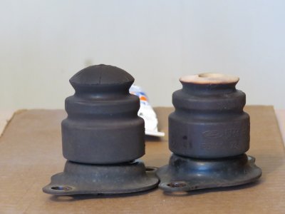

If you're going to cut the stock bump stops down, it's probably best if you start by cutting only a little. You can always cut more off if you feel that you need to, but you can't put it back on if you cut more off than you had to. Bump stops perform a useful function, so it's best to keep as much of that usefulness as you can.
There are DIY ways of putting some of the softness lost by cutting the soft end of the bump stop off, back in.
