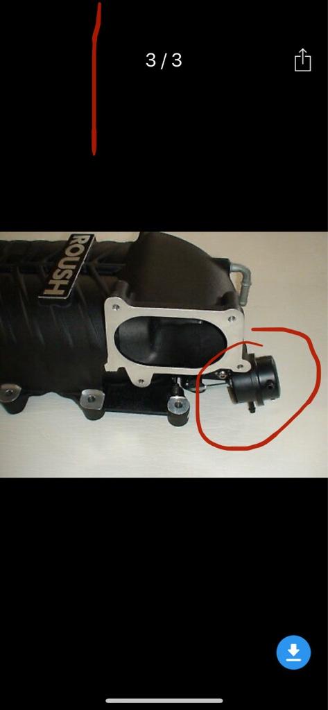

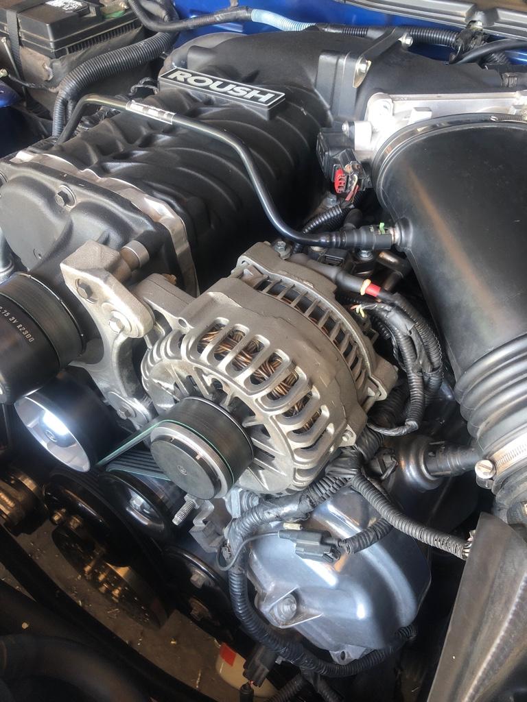

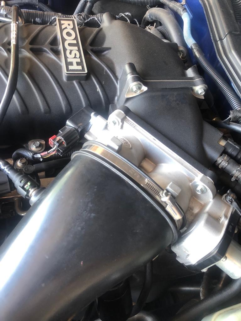

Did the TVS come with a bypass or is it constantly pumping air into the motor?
I believe it has a bypass, I’m kind of new to the supercharged world[emoji3] Here’s a pic
I’ve had it for about a year and a half. Still learning. Not really sure of the bypass location.

The bypass actuator on the TVS is vacuum operated. Not dependent on RPM. As already stated make sure the vacuum hose is connected to the correct port. You really only need one side hooked up to operate. It is opened with vacuum. The only complaint I have read about is some cams don’t provide a good vacuum to open the valve and you get Blower Serge trying to idle. You need a different tuner as well.
