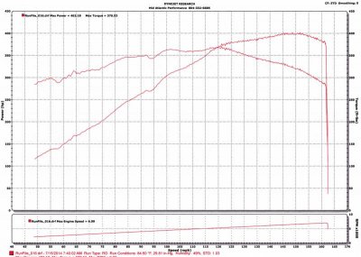

Dyno sheet, just for fun. I made 402/370. He used STD correction and the factor was 1.03 so if you divide by that my uncorrected numbers should be around 390/359. That day the conditions were, 84.60 deg, 29.81 inhg, and 49% humidity. Now I know the current widely used correction is SAE. But he uses STD I guess. If you calculate for SAE my numbers would be about 392/360. Which is pretty close to my uncorrected numbers. Some people say STD is a "fluffed" read out but the reality is, is that it's just a different calculation. One is not right or wrong. STD is just the more optimal conditions of the two. And where we live it's not uncommon to see similar conditions in the fall/spring. So for me they are pretty realistic. As you see SAE is closer to my uncorrected numbers because they are closer to my actual conditions where we live on a cool summer morning. My tune was done in the morning in the middle of July. Now if we lived somewhere else in the U.S., like Denver, I would not be able to argue these points. And would probably want to stick to SAE for comparison purposes to other people because it is more widely used. And at that altitude probably won't see conditions any where near STD. And uncorrected numbers up there will probably just depress you. :p

I saw that temp on the chart and I wondered when, thanks. Mike will have mine back on the dyno, with the new intake pipe and BA500, next week.
yeah he started pretty early in the morning, at like 7am. I was hoping for a little cooler temps. But I feel it did well considering.
