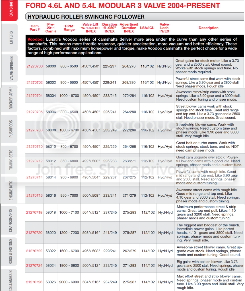

Since there is little info on Lunati cams I though I might add the specs, the info is from Summitracing.
NA cams:
58000 800-6500rpm 225/237 @.05 .45/.45 116LSA -NSR
58002 900-6600 229/241 @.05 .45/.45 116LSA -NSR/need phaser
58004 1000-6700 233/241 @.05 .45/.45 116LSA -NSR/need phaser
58012 850-6800 225/233 @.05 .492/.5 112LSA -SPR
58014 900-6900 229/237 @.05 .496/.504 112LSA -SPR
58016 950-7000 233/241 @.05 .5/.508 112LSA - SPR
58018 1000-7100 237/245 @.05 .504/.512 112LSA - SPR
58020 1200-7200 241/249 @.05 .508/.516 112LSA - SPR
SC cams:
58006 800-6500 225/241 @.05 .45/.45 116LSA - NSR/need phaser
58008 1000-6700 233/249 @.05 .45/.45 116LSA - NSR/need phaser
58022 1500-6700 229/241 @.05 .496/.508 114LSA - SPR
58024 1800-6800 233/245 @.05 .5/.512 114LSA - SPR
Turbo cam:
58010 800-6700 225/229 @.05 .45/.45 116 - NSR

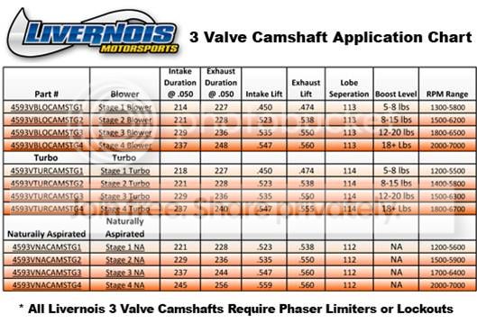

I have been eyeing the 58012 for my stroker/Vortech build.

Lunati cam's from the Lunati hompage.
