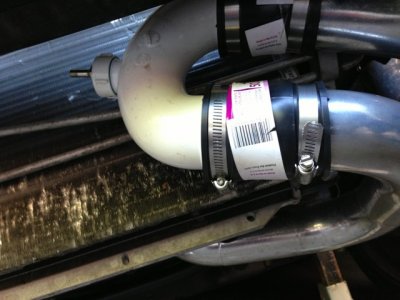

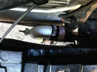

The other day I was out doing some logs for Lito. Everything was going great but he wanted me to lower the boost until we got the tune more dialed in because I'm still on my stock plugs. I was at 9psi but decided to bypass my tru-boost and just run wastegate pressure for now. I unhooked the boost solenoid and ran a line direct to the wastegate. During my log my boost skyrocked and triggered the alarm so I let off. When I got back to the shop I noticed I put the wrong line into the compressor housing. I accidentally ran my boost reference to the top port on the wastegate. After putting it right it will not build any boost.
Smoke test didn't reveal any leaks
So Im confused

The duty cycle could have been sky high to get the turbo to 9psi to start with.
If you measure the pressure drop of that cooler you'll know for sure.

I'm not sure how to measure the pressure drop on the intercooler without having some nipples welded onto the inlet and the outlet. It's already going to cost me 60 bucks to have that one pinhole welded up. I know earlier you talked about tapping them. Should I just drill a hole, buy a quarter inch tap, tap it and thread some nipples in?

Yeah, but use a 1/8npt tap. Stand the cooler on the hose end side while you work. Drilled and tapped aluminum will mostly fall out on it's own. If it is fact dropping all that pressure thru the core your back pressure is likely close to 3-1
Macdaddy you only need to measure once at a given boost level really, as a baseline. Any more than that you'd just he monitoring to see if compressor pressure goes up as an indication of a boost leak somewhere.
