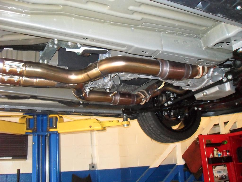

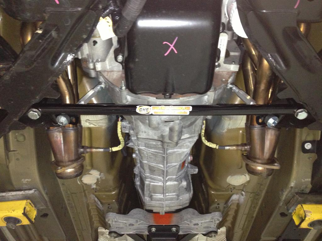

Or stick with the stock headers and save your money towards a supercharger kit instead.
I'm planning on eventually supercharging my GT. And I was wondering if I should I get kooks LTH with the catted x pipe or should I go shorty headers? Right now I have BBK long tube headers, 2 3/4" high flow catted x pipe and 3" catback with a custom muffler delete since MBRP doesn't make a 3" muffler delete. The problem is the cats are so far back on that setup that they can't get to full operating temp sometimes. Which made my cel come on every once in a while. I mean these cats are pretty much under the driver seat, they're that far back. The kooks are way further up. Do you think that #1 I won't have that problem with those headers and #2 if so, is the horsepower gain enough to justify the $1400 purchase? The main thing is that I have to pass emissions so I cant have a cel and the rear o2s cant be turned off because they plug a computer into it so see if all the monitoring systems have been run and if they passed. Also should this be in the tech thread?
