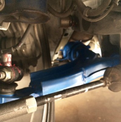

I had this same clucking in my 07GT whene I got it turned out hte balljoints where shot. I decided that replacing the ball joint themselves was more trouble then just replacing the entire lower control arm with the GT500 one. I did and it took care of the problem... Best of Luck.

Same as Monkeyporn, worn out ball joints on mine making the noise. Replaced both lower control arms and now its quiet as can be
